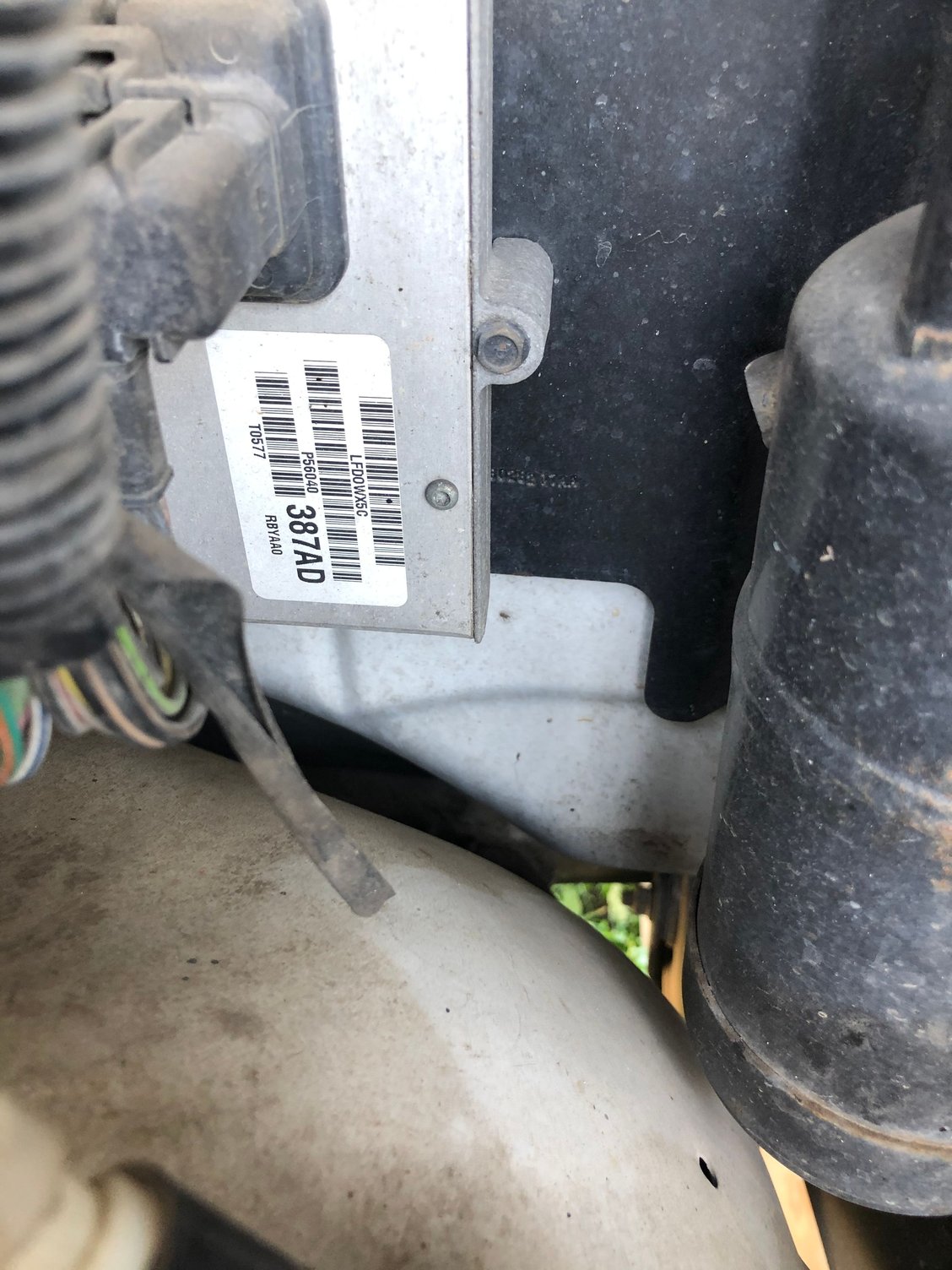

so in the chance it is my PCM I’ve been shopping around the last few days for one. I’ve found used ones on eBay that match my part number or remanufactured ones from carddone
half the people say it will need to be programmed other half day it doesn’t.
i “think” I remember you saying it doesn’t need to be programmed for my year.
1.If I get one from let’s say O’Reilly (remanufactured) with possibly not the same 387AD part number wood it need to be programmed?
2. If I get one from eBay (used but 1/3rd the price) that does have the 387AD part number would that need to be reprogrammed?
ive included a picture of my current one

The 97 trucks don't really care about vin matching, which is what the whole 'programming' thing is all about. So long as the PCM is for the same engine/trans combo that you have, PCM from 96 or 97 truck will work. 95 and older are OBDI, and are totally different, 98 and up, the way things worked changed dramatically, so those simply won't work either.
If you can get one locally for a reasonable price (junk yard?) from the correct year, and engine/trans combo, should be plug and play.
Cardone REALLY doesn't have a good rep on their remans..... but, I don't know of anyone that does..... The advantage of going to your local parts store is, if it doesn't work, you can simply bring it back.... and swap it for another one. (or get your money back....)
