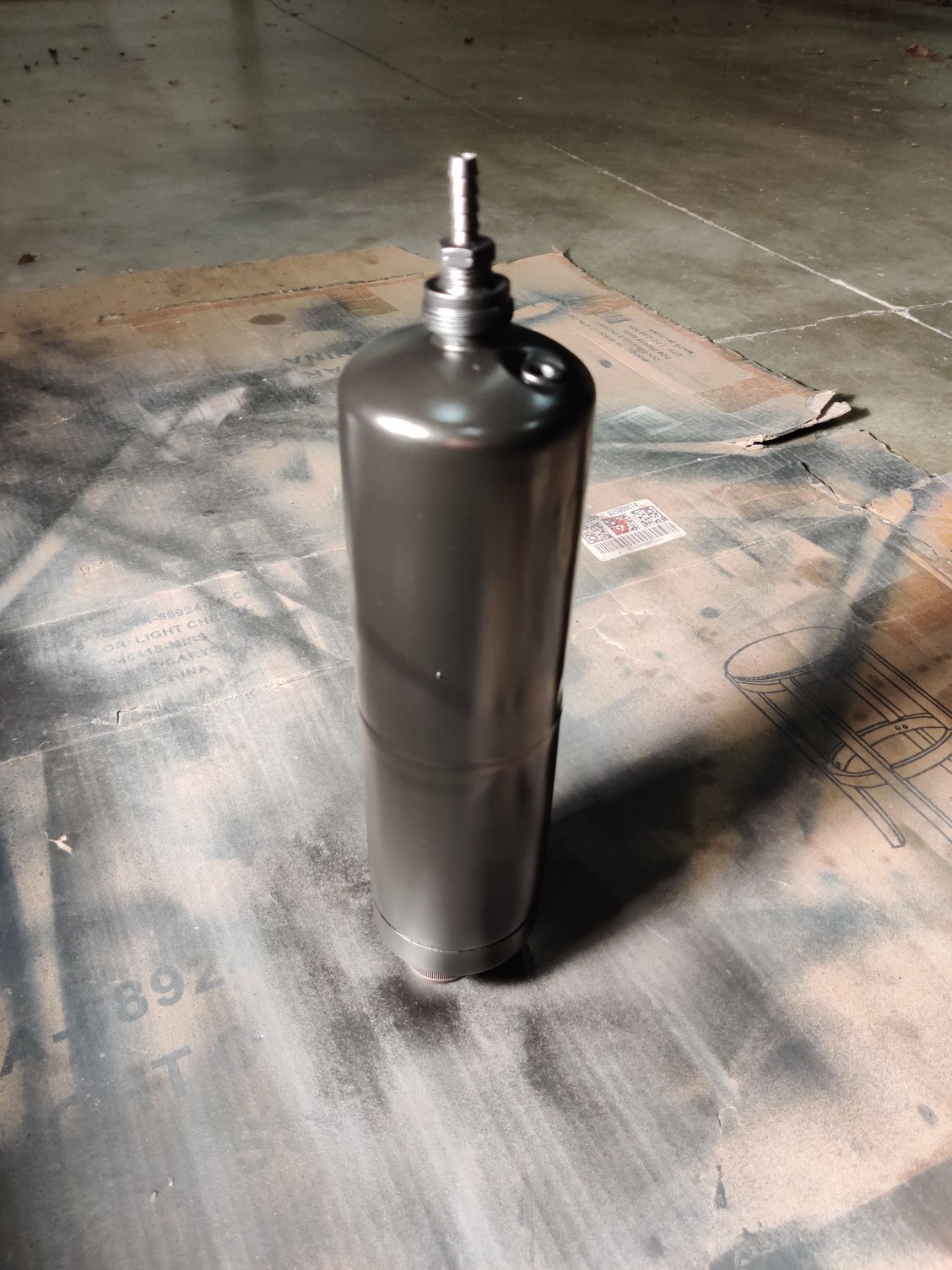

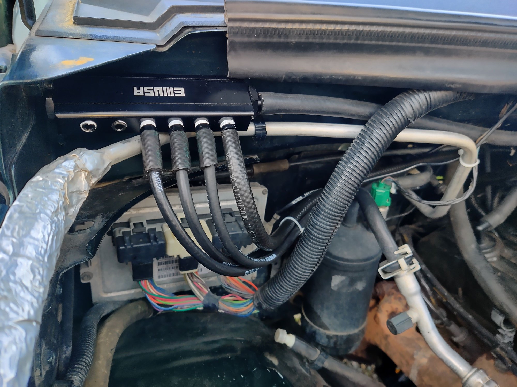

I did get the AC delco check valves. The black ones. I had them backwards at first but I fixed it recently. But I still had the wild vents when my vacuum dropped down near zero Hg at high throttle input for more than 15 ish seconds. I added the extra vacuum tank and problem solved. I think my plastic vac tank is cracked or something. After I re-did the vacuum system I still had the wild vents until I added the extra vac tank. I might try capping off the factory vac tank and see what happens. Attached are pics of the vacuum distribution block I installed and the home made vacuum tank. A brass hose fitting soldered to an empty propane tank with the valve drilled out. haha I ended up hose clamping it to that cylinder AC component. All the hoses sealed up well. Overall it seems to work well.
where are the check valve if you installed that distribution block?
It's about 2"-3" away from the inlet on the side of the manifold just like when stock. I can't remember where the second one in the system is off hand but I replaced that one too.

If so, the only thing left is the hack vacuum setup keeping certain vents closed or blocked.
