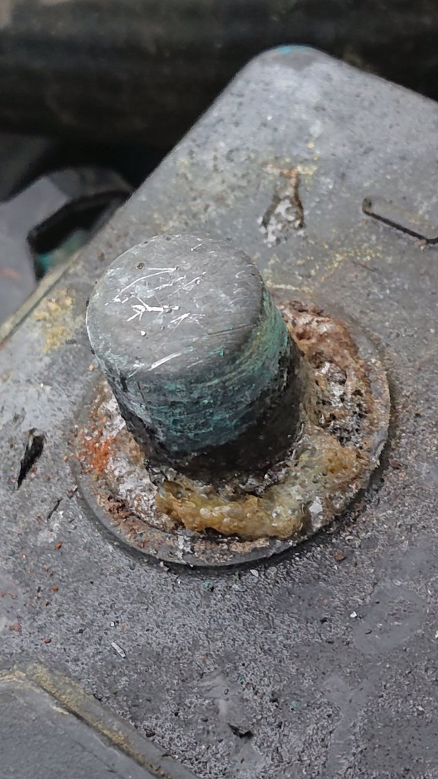

Also this is the negative battery terminal. Is this substance leaking possibly due to under charging? Or is this a good sign the battery is shot?

Ok the plot thickens. I pull a 12.5 or so charge off the battery with no drop between the altinator and the battery. Then I pul of the negitive battery terminal to check out that bubbling and then I put it back on and it starts right up like a champ. I'm still only getting 13.5 off the battery with a. 3 drop from the alternator. Any ideas?

Clean the battery terminals and clamps REALLY well. May just solve your problems.
OK just did that. Still only getting 13.8 when it's running 13.5 with lights ect on and 12.5 when it's sitting. We will see if it has trobble starting again or if thoes bubbles return. Thanks!
