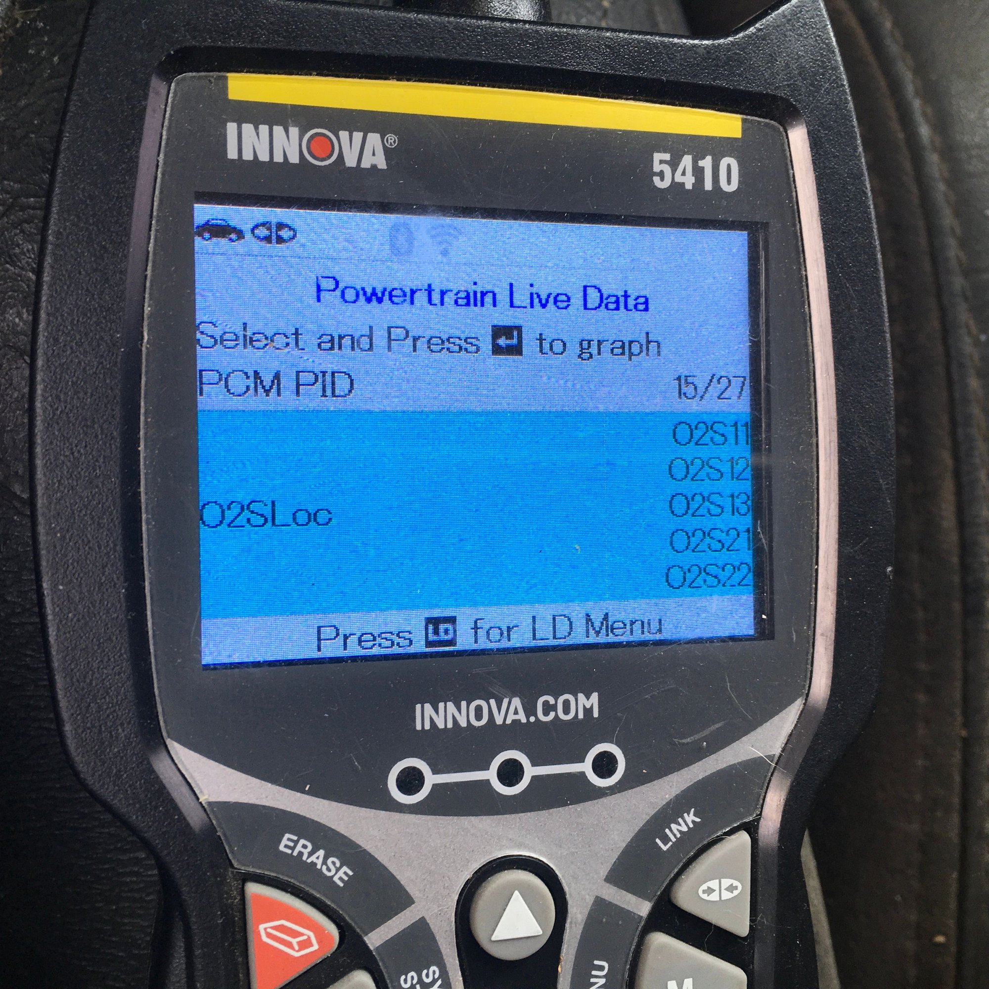

Ok, so I hooked up my obdII meter to the truck and I swear it says I have 5 oxygen sensors. Bank 1 sensors 1, 2, and, 3 and bank 2 sensors 1 and 2. Is this correct? Smh! Thanks, Lynn

On the california models, I just don't know. If it were me, I would just replace the three "front" O2 sensors, and call it a day. The rest are just to monitor the cats anyway. If you aren't getting codes for 'em, don't worry about 'em.

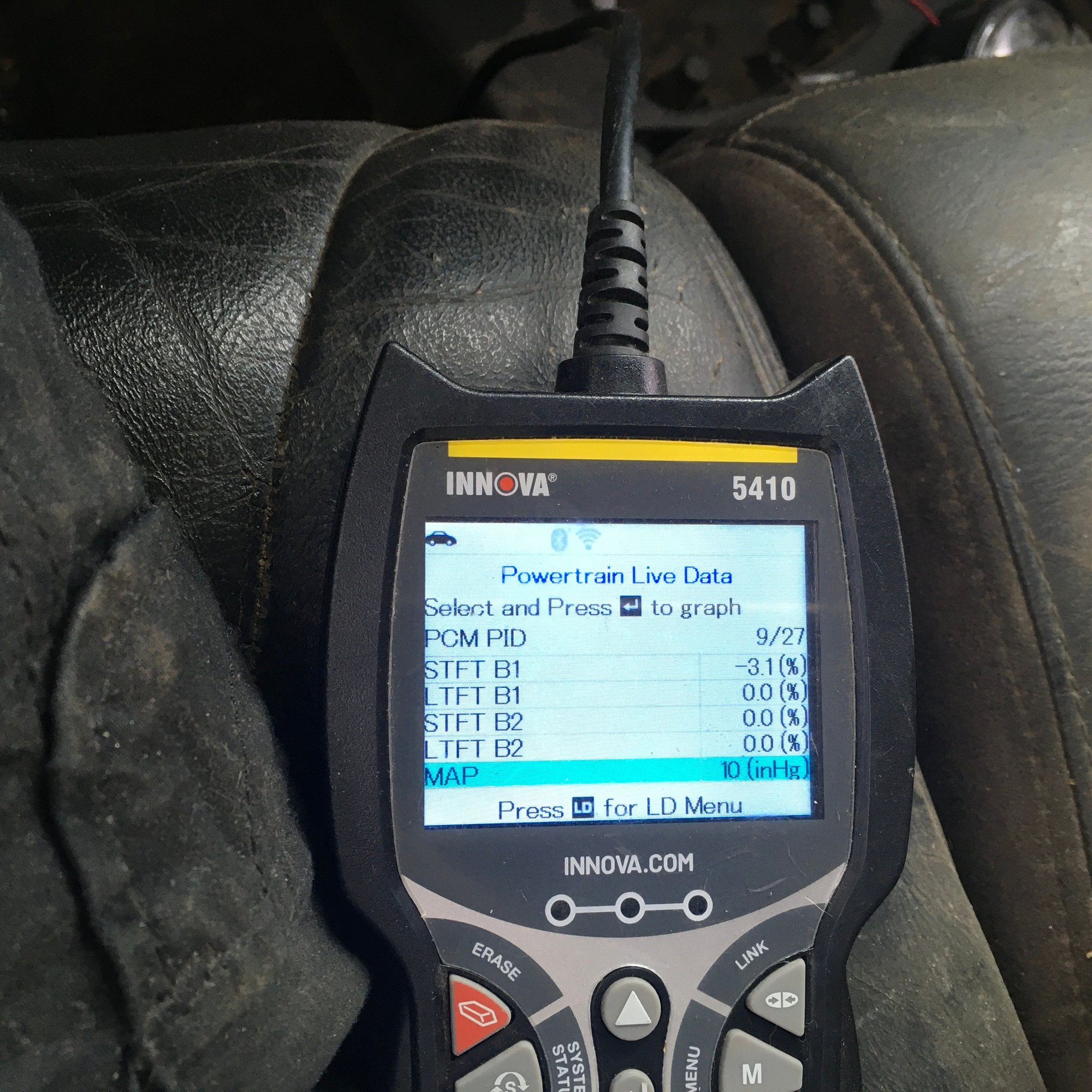

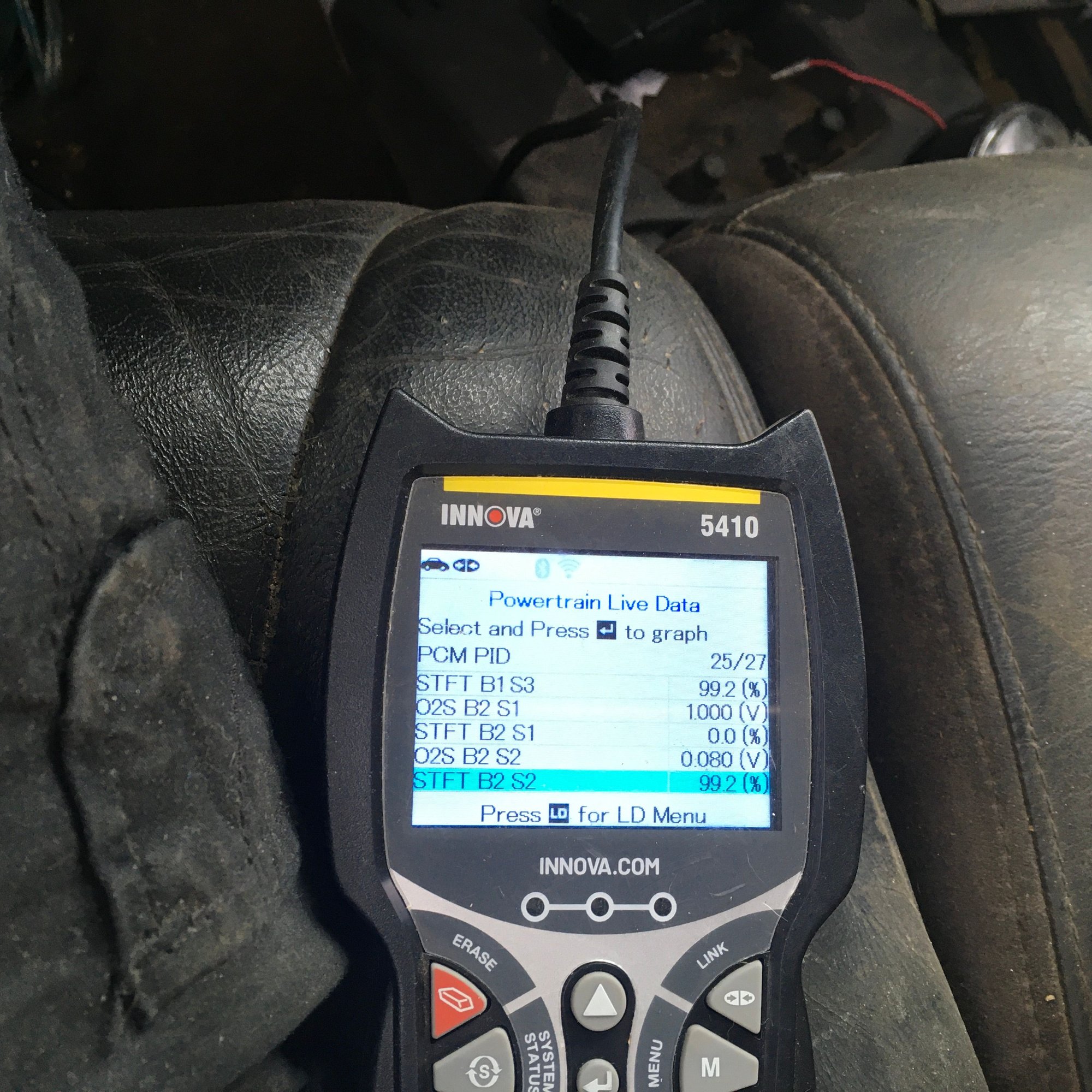

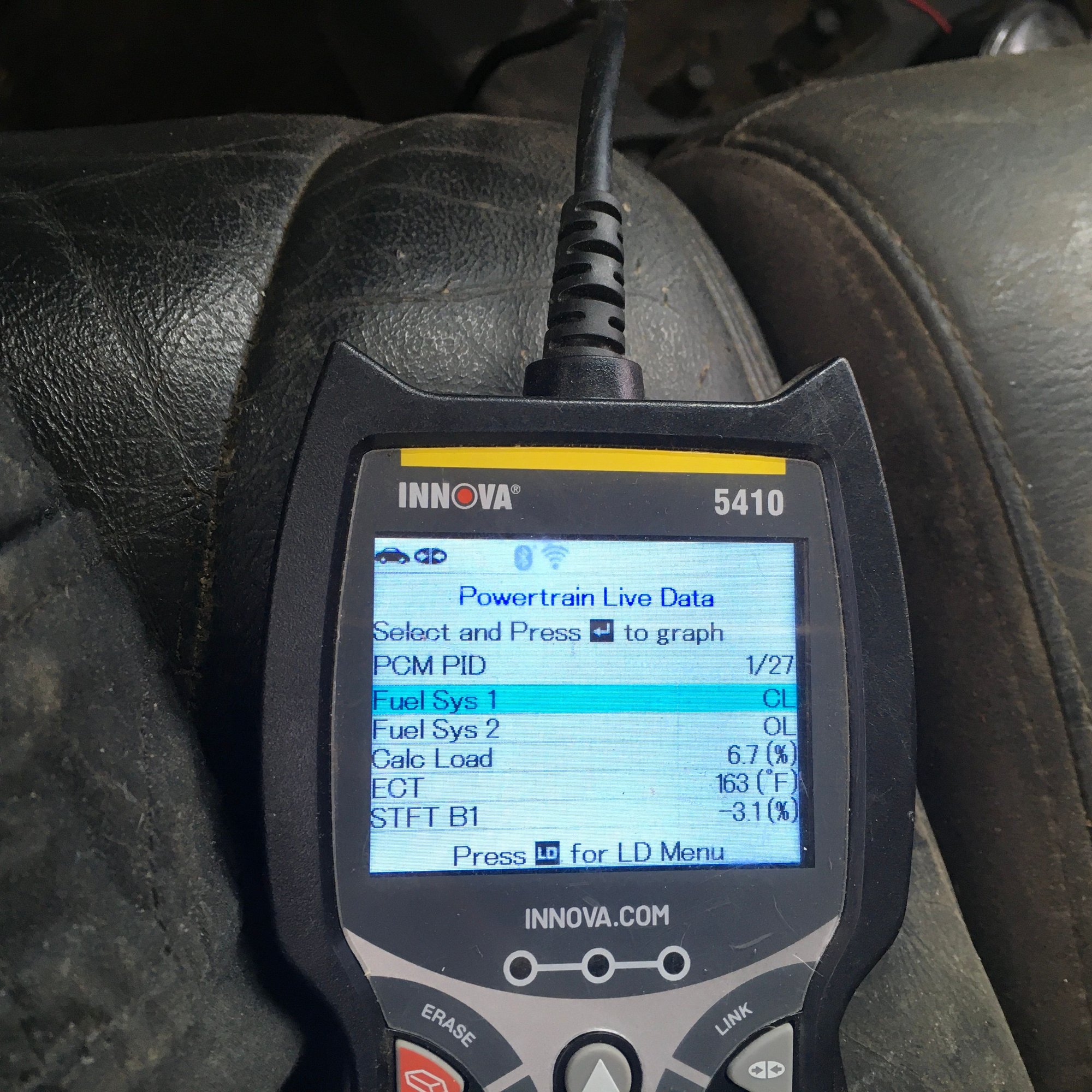

I’m trying to get my mpg back, plus pass smog, I passed emissions but not the monitors, anyways how important is a fully functioning o2 sensor system in terms of miles per gallon? It’s a v10 so it’s bad enough as it is, lol. It was 7.9 when I bought it and I had it up to 12.3 when it started giving me issues. I just replaced the fuel pump and o2 sensors at the same time and these are the readings I’m getting after starting it twice. Thanks folks
This is showing 5 o2 sensors, right?

What brand O2 sensors did you put in?
The numbers look ok. I just ignore the fuel trims of the rear O2's. They just monitor the cat anyway.
It may show a third sensor in there, but, that does not necessarily imply there IS one.... So far as I know, you should only have four...... But, again, cali emissions, and they do things their own way......

What about the open loop?
Old Oct 2, 2020 | 05:56 PM
Posts: 87,566
Likes: 4,232
Certain things have to happen before the PCM will drop into closed loop, engine temp, X amount of time has to pass, and it needs to see the sensors switching properly. Until all those conditions are met, the PCM will stay in open loop. Under normal circumstances, once engine temp gets above like 100 degrees or so, it *should* go closed loop. If it's not, then something is missing from the equation. Since one side IS in closed loop, and the other side is not, they only thing they DON'T have in common, is O2 sensors......
