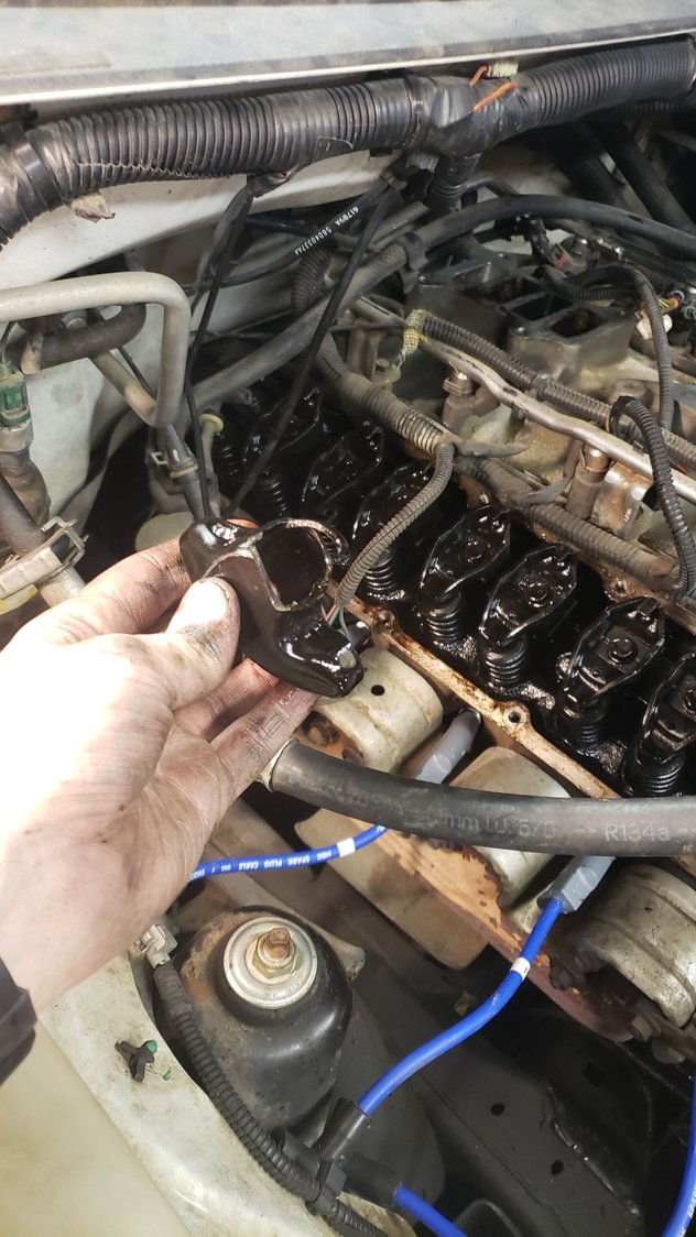

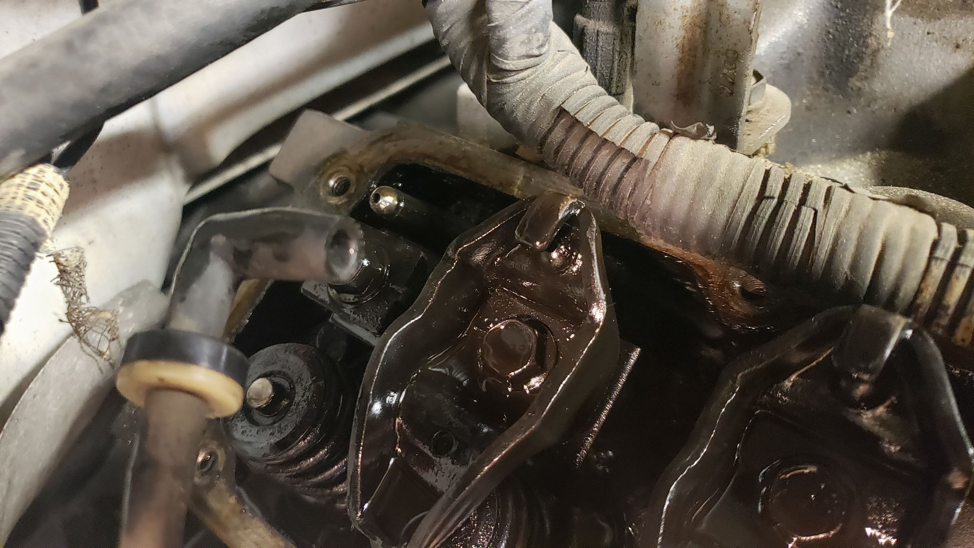

The GREAT NEWS is, I pulled off my valve covers and immediately found the problem. One busted rocker arm and two bent push rods, all on the passengers side. Driver's side was good, but I removed it all to clean in the parts washer at work. Wasn't as bad a job as I expected, took about 2 hours for a first timer to get it all apart. Also have some chafed injector wires I need to insulate.
Have a buddy hunting down spare parts for me, then hopefully I'll have the engine in tip-top shape and ready to start on that pesky front end!

Now the question is what caused all that
I think it's pretty clearly just a case of bad maintenance. I'd say with the oil pressure issues it was having that part of the engine got the least lubrication. I'm really not concerned about it, it seems to be in good shape everywhere else.

To bend a push rod I doubt it was low oil pressure lol
