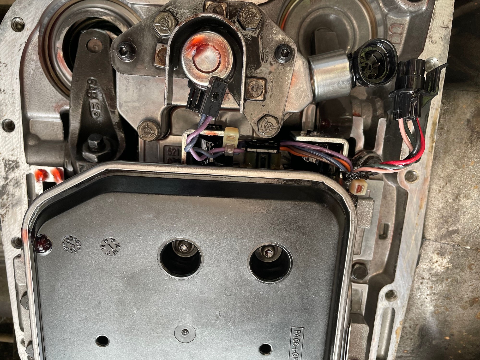

I will first check connection. If i am correct, from the info i could find... i would need to pull the pan to test the solenoid?

3.7 ohms is what i measured across the solenoid that had the blue an purple wires going into it. Is that helpful at all to this situation?
i tried to get a measurement off of the solenoid with 4 probes but i couldnt get anything off of them.
Old Dec 14, 2020 | 04:18 PM
Posts: 87,465
Likes: 4,220
The 4 pin is a pressure/temp sensor. No clue what those should be reading.....
I *think* your resistance is good.
