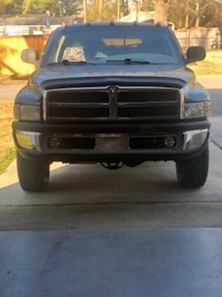

The bean is out of the garage!!! Did a quick test run and nothing broke or leaked. I greatly appreciate all the knowledge and advice. Believe me, I would have broken a lot more stuff than I already did. I'll take it out again tomorrow give a decent test. Haven't locked it in yet, definitely want to do that. Did I mention I am sore as hell. Thanks again guys!!!
