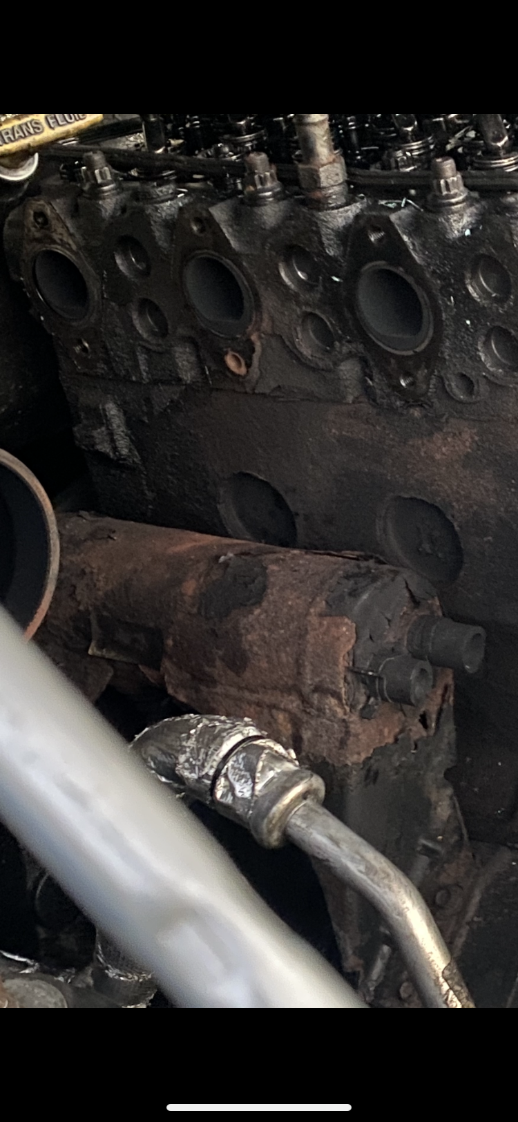

What is this? Is it worth replacing and reinstalling it? It was like this.
