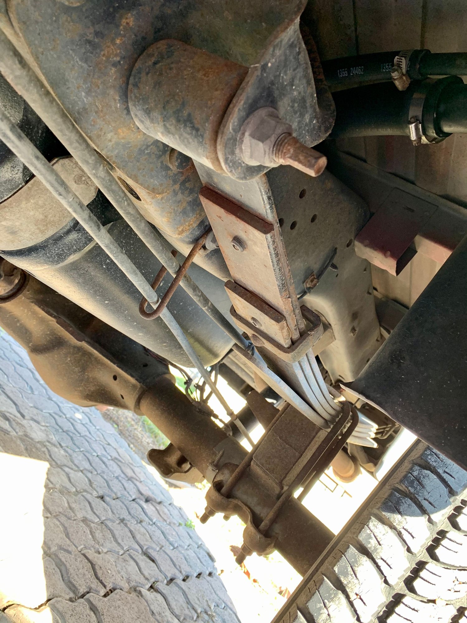

Here are the leafs.

Posts: 87,572
Likes: 4,233
Looks stock to me.

DerTruck's Avatar
DerTruck
Joined: Dec 2018
Posts: 1,088
Likes: 172
Camper special springs, also note the anti-roll bar which the pic above does not have.

Liddlez's Avatar
Liddlez
Joined: Dec 2019
Posts: 257
Likes: 14
From: Texas
Those are some unique springs!
