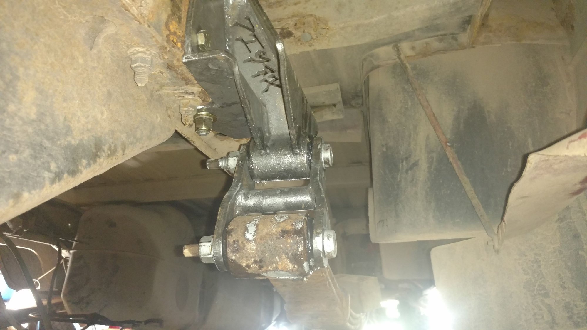

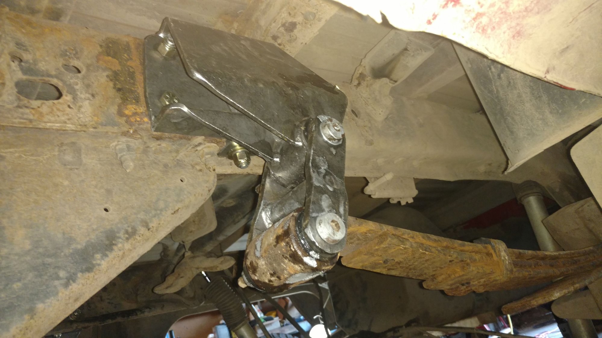

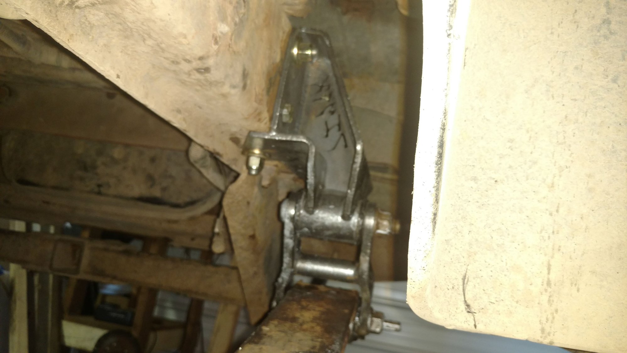

diy4x.com on a 2500

You installed that on your truck? How do you like it? How much lift?

^^^I like the uber duty shackles there. Factory stamped sheetmetal will fold over in time because the leverage on the shackles is much greater in compression than in tension
edit: it's easy to reinforce stock shackles with flat bar and bright light + sparks, though ....er I guess the sparks are optional if you TIG it
