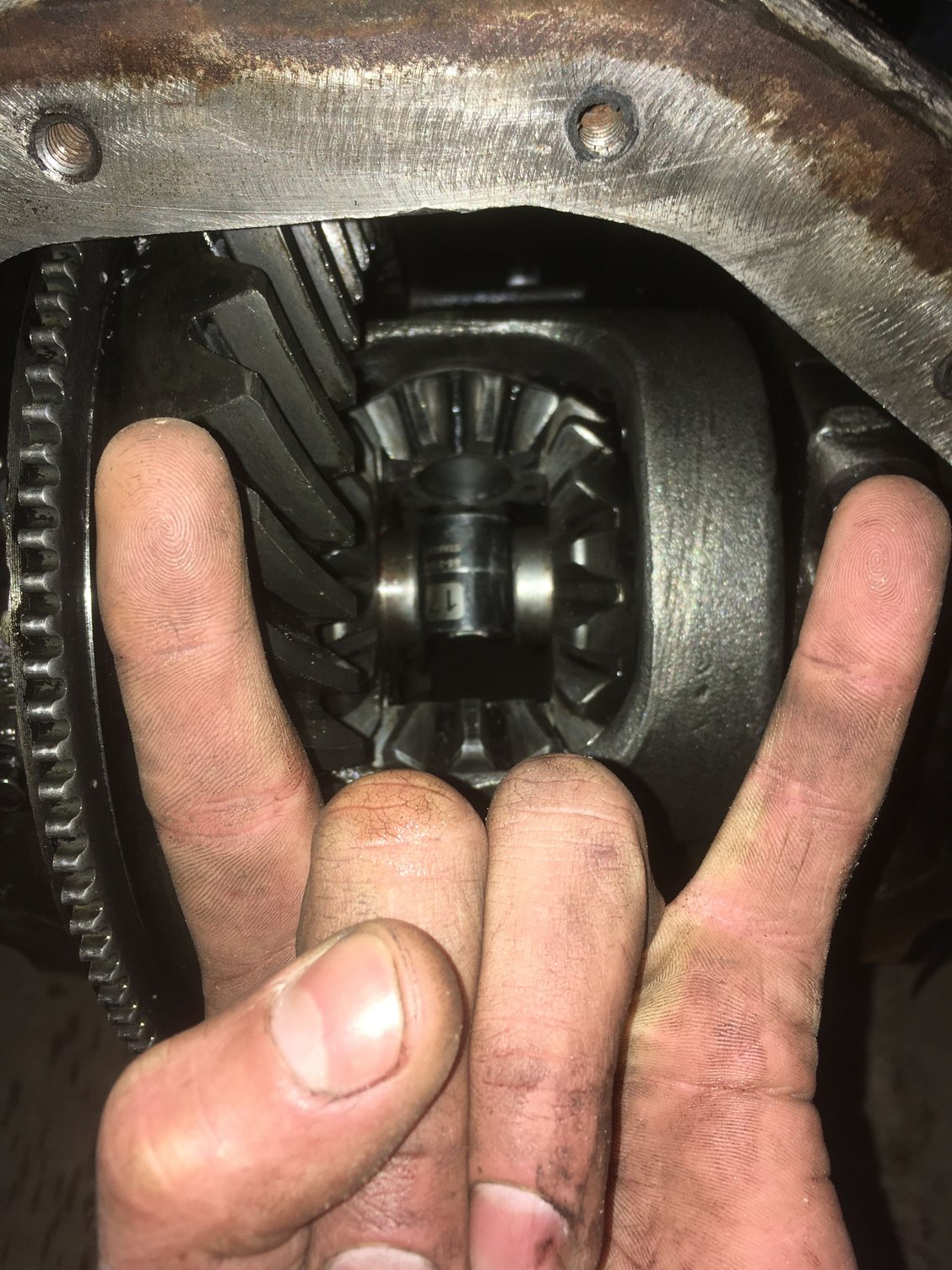

yeah figured so. I had people saying all sorts of stuff. Was figuring a way to compress them. Got some threaded rod. Was gonna rig it up and had an idea. The carrier pin is 16mmish. I grabbed a 17mm socket ****in pried the **** out the axles and slipped the socket in. Gave me all the room in the world. Gonna make a post it worked so great hah check this pic out
