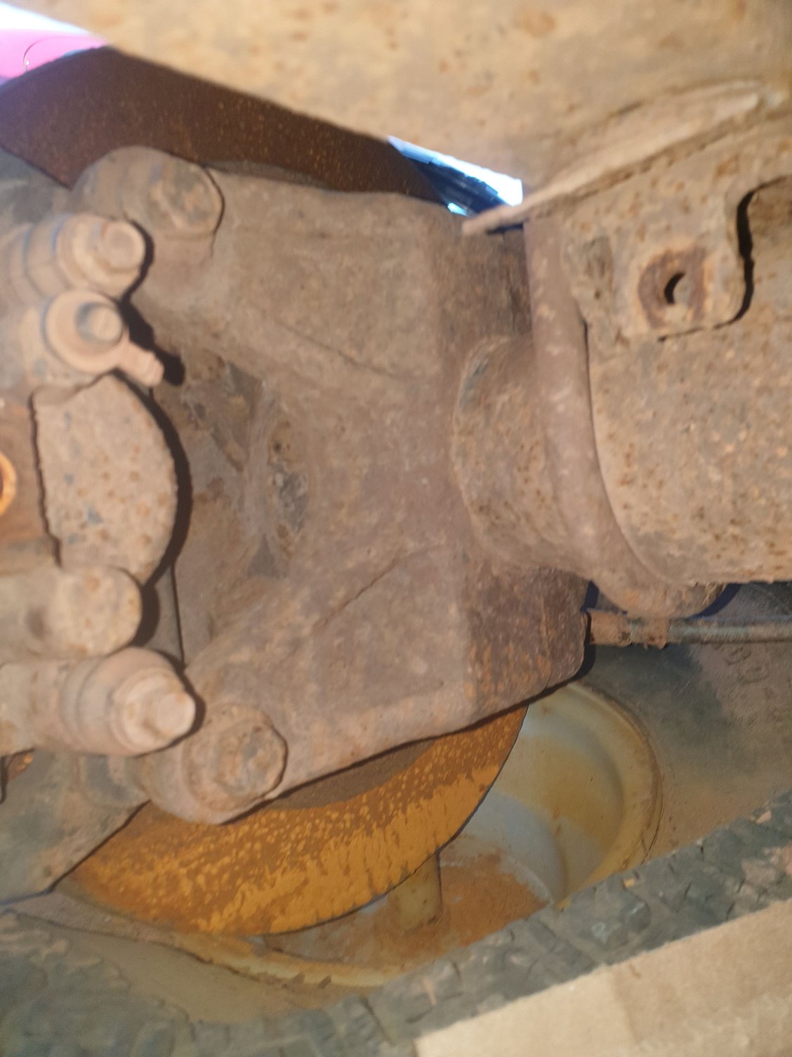

Does anyone know if the rear axle from a 3rd gen will fit under it? Only difference is they are disk brakes, I found a rear end with the same gears and limited slip but off a newer truck, it looks like the brake caliber bracket is just clamped on the axle tube so im thinking possibly the brake drum mounting spots are still there just not in use?

Different mounting holes between drums and disc brakes. Physically the whole axle will fit under your truck. I do know the driveshaft mounts differently is used a flange style mounting where early second gens used u joint straps. You can but the flange though. The issue is the leafs I believe all 3rd gens used 3in wide leafs whereas the 2nd gen 1500s used 2.5in leafs. There are a few ways around that

q1
This is a 2002 3rd gen the rear caliber bracket is just clamped on the axle im thinking the axles are identical, I could see if the drum brake mounting spots were there tho

The disc brakes on it should work just fine on a second gen. I swapped out the drum brake Dana 60 rear to a 2001 disc brake Dana 60 rear onto my '96 2500 4x4 truck and didn't change the master cylinder or proportioning valve and it all works just fine. Stops great..
