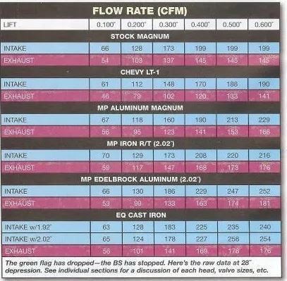

Cylinder Heads
See attached images
Advantage - Vortec

As you can see, the Vortec heads are better, but with the wimpy stock camshafts these engines run neither is maxing out the head anyway.

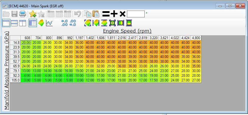

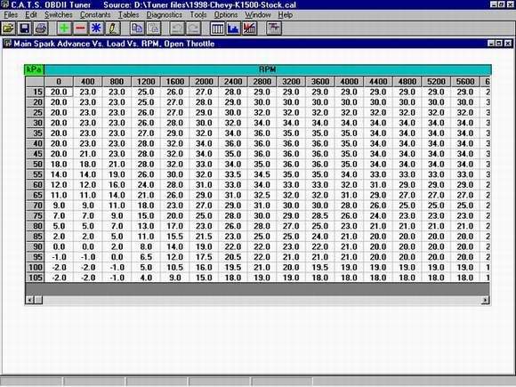

Nice theory, but the data doesn't agree with you.
Below you will find the stock spark tables for my 2001 Ram, and a 1998 Silverado 5.7 respectively. As you can see, the Dodge has much more aggressive spark tuning.
You are correct that the 4l60e transmissions have a lower (3.06) first gear than the 46re (2.45). However, that is likely more than made up for by the difference in rear gear. 4.10 in the Ram vs 3.73 or 3.55 in the GM. Also, the GM feels stronger everywhere, not just off the line.
Yes, 245hp rating for the 5.9, but only putting down 160-180 indicates they were probably overrated. The GM being rated at 250-255, and putting down 225 on a consistent basis.

For the GM, the tables are just a suggestion. The computer will adjust timing on the fly. That's the advantage of having the knock sensor. The tables are more of a failsafe, for times when it is running open loop, or limp mode.

I highly doubt that even if the GM ecu is correcting on top of that base table (and the dodge isn't) that it would run any more aggressive timing than the dodge is in the base table. 40 degrees is a lot of advance and it's there a lot of the time.

There are several other tables in there that influence timing as well. The base numbers you see there are exactly that. Base. They will also be modified by coolant temp, intake air temp, etc, etc,.
