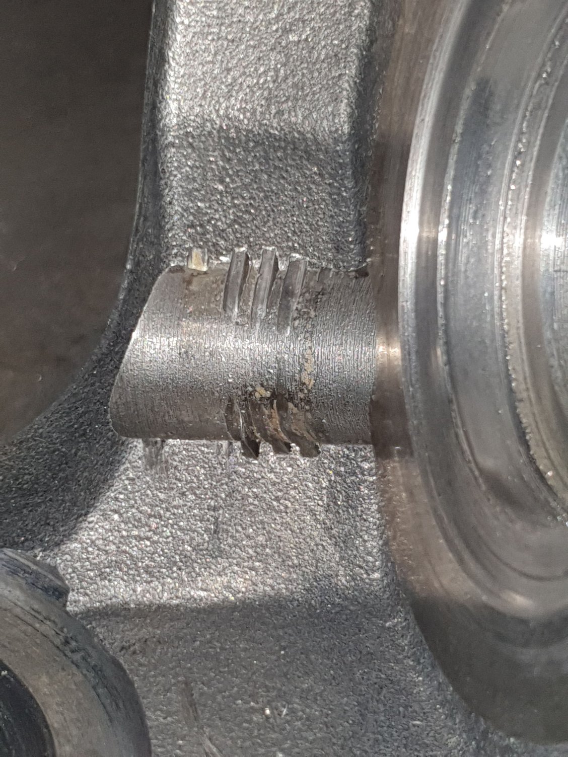

Hey everyone im in the process of rebuilding the limited slip in my 2001 ram 1500, after I pulled out the spider gears I noticed that on the passenger side of the diff the clutches dug into the housing where it is notched to hold the clutch plates in, has anyone ever built up the material there by welding and grind it down to shape? Im good at welding and i know I can get a round file and a die grinder threw the side hole to give it its shape again but I dont know what kind of cast this is or should I use stick or might welder, also do I even need to worry about this because the clip itself should hold it all together right? Only reason it happend is because the clip fell out then the clutches dug in, my donor rear end has the same issue and I searched this island high and low for these limited slip differentials I think I have the only 2 😅 so im stuck fixing this one, I will post pictures of the damage and the chewed up spider gears later! any advice is appreciated thanks!

It looks like cast to me because its very pourus but maybe its not cast ain't very strong when it comes to torsional stress which a rear would see lots of, I do have a donor differential im gonna try welding on first and see what happens! Like I said earlier do I even need to worry about welding the grooves if the clips are what hold the clutches together in the first place?

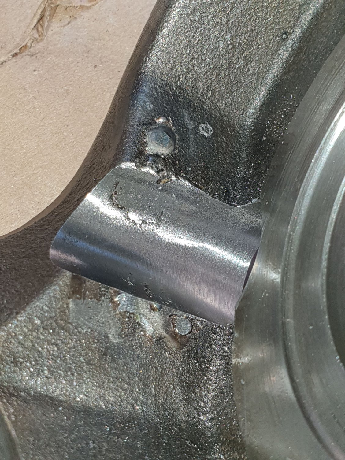

Well here is the fix just heat up the metal and spot welded over the area with a mig then grinder it to shape with a air grinder and stone, hope its a bit stronger then it was before it welded very easily just like normal steel1
