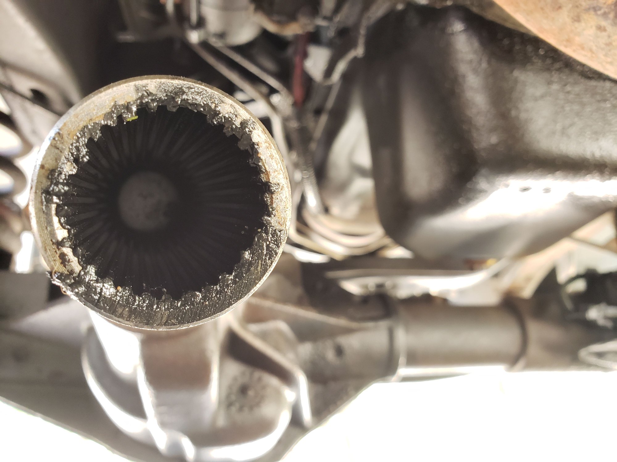

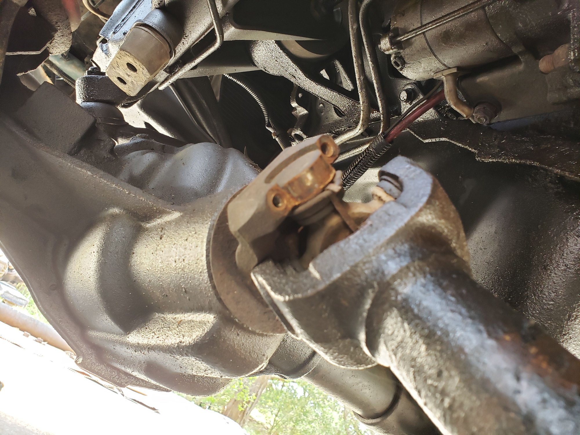

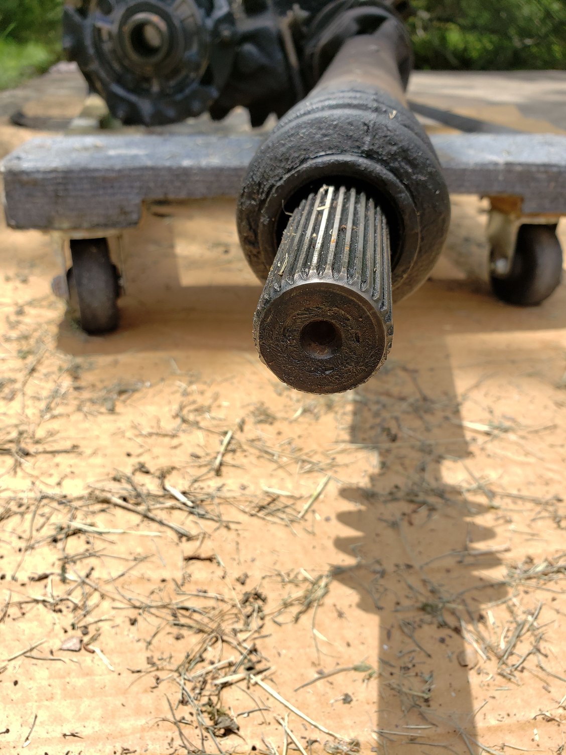

I'm thinking the same type of thing, with a bit more focus on the front driveshaft, since the transfer case seemed to **** sideways to break the overdrive housing in that manner..
Could it possibly be an issue with your double cardigan joint on the front driveshaft, a balance issue with the front driveshaft or an internal issue with the transfer case?
I'll grab some more up close pictures if maybe there's something obvious I'm missing. It seems like maybe I should probably replace the entire tranny/drive train at this point.. I don't want to but if its just going to break again when I put a new housing on..
For a short service history- about 5 months ago I did a coolant flush to get the heater working during the Texas freeze. That worked but it blew my head gaskets shortly after. That was fixed and then the transmission was throwing a code about a solenoid. Can't remember the exact code. Did a transmission flush, changed out the filter. Worked like a champ and then the overdrive housing cracked like the next day. I filled it up all the way with fluid, checked it in neutral.
Idk how a transmission flush would lead to an O/D housing explosion but it was the day before this happened.
I did go to the wrong website, woops. This one was more helpful but only pointed me towards one vendor whos 1500 miles away

Rust on rust
Front driveshaft... sleeve?
Behind front driveshaft sleeve. Not sure if that gap there is alright
Inaert front drive shaft here
Front driveshaft
One last pic of f shaft

Personally, I'd remove the front driveshaft from the transfer case and check those U-joints for proper movement. Also, remove the yoke from the front differential and check that U-joint for proper movement. If you don't feel comfortable with checking, I'd take the complete front driveshaft to a driveline shop and have that front driveshaft checked out for balance and the U-joints for functionality. Also, I'd replace the rear driveshaft U-joints, too.
