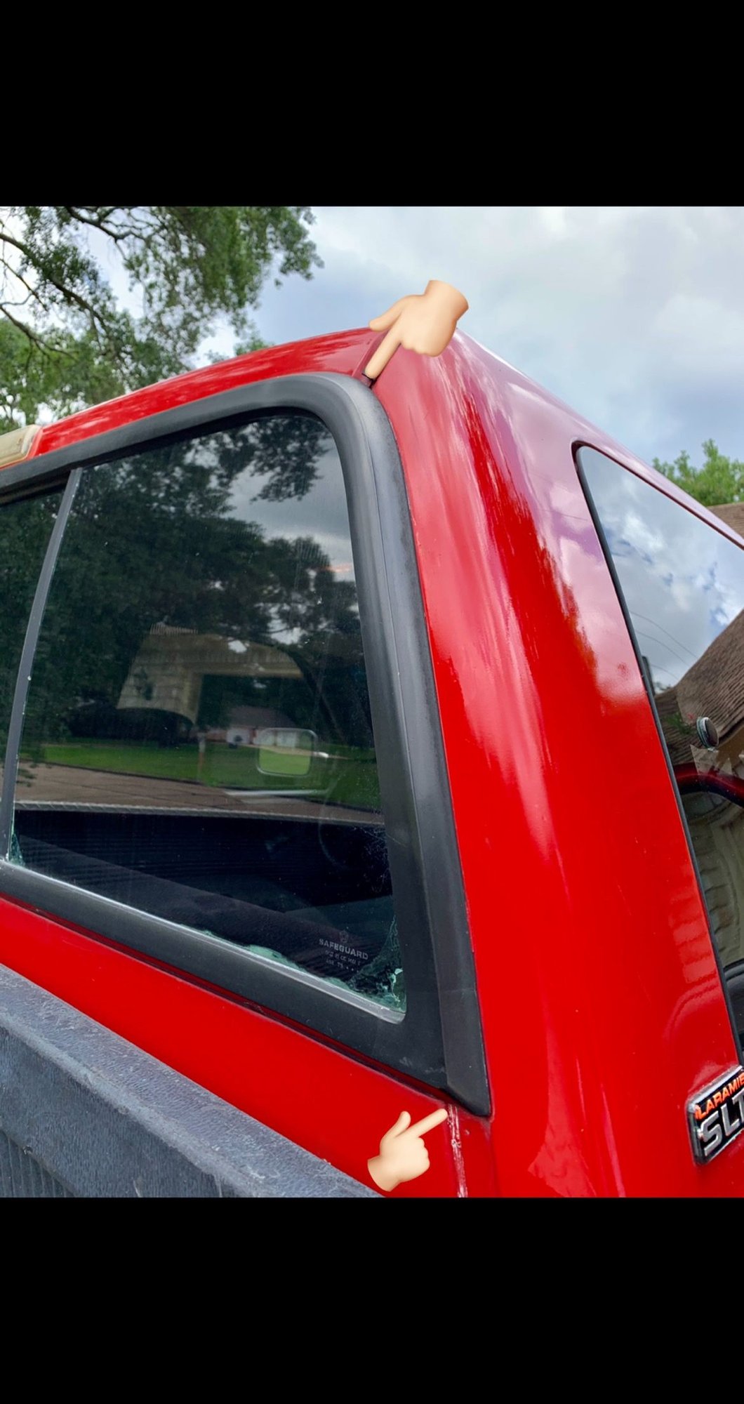

Are these the sealing points you are referring to?
Old May 26, 2021 | 02:39 PM
Posts: 87,487
The ones at the top are the most notorious.

That's the spot brother!!! Make sure that the corresponding hole at the bottom is in some semblance of being open to drain!
