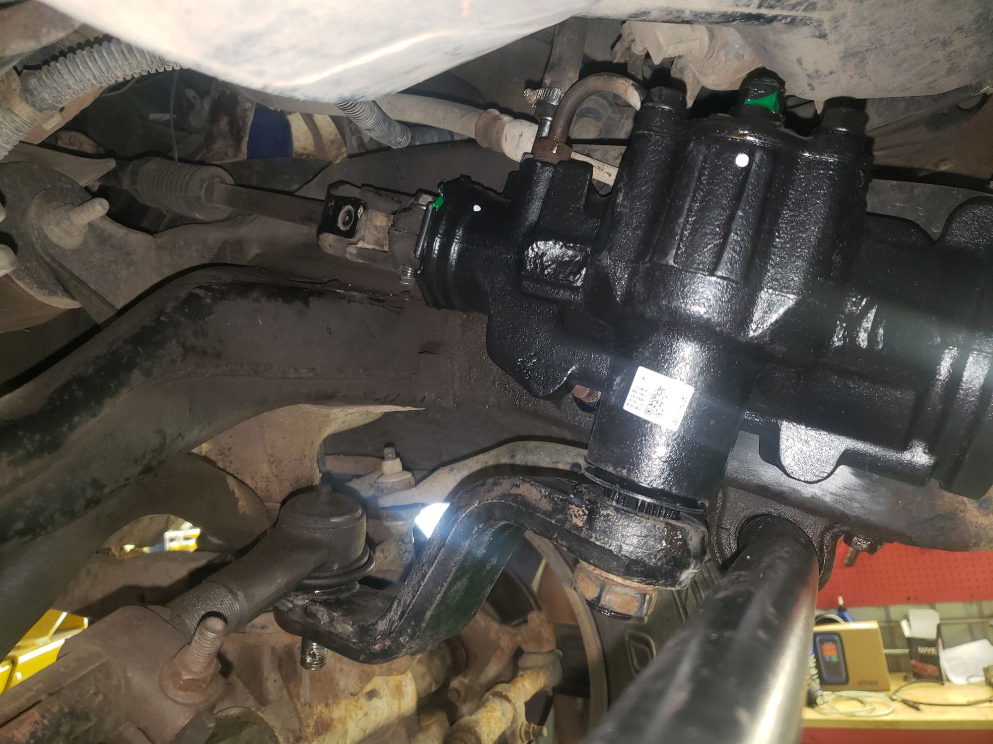

Ok well I can confirm that a 503-0146 fits a 2000 MY even though the listings don't reflect it for this year.

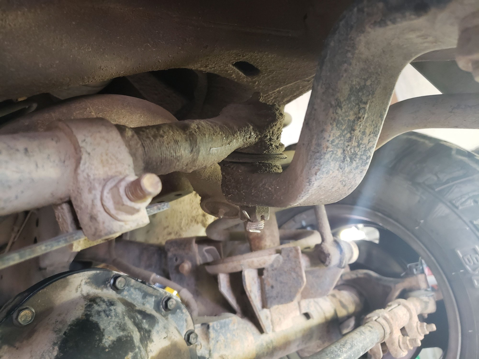

I can also confirm that the previous mechanic who worked on this 2000 and managed to install the front brake pads backwards (metal backing facing rotor) also installed the drag link into the pitman arm the wrong way. It's a wonder it lasted this long without the taper fit...
Correct
Not correct!

So it was installed upside down or you put it there? The drag link should install on top of the pitman arm unless it has a drop pitman arm which merely reverses the taper. Also, how do you install brake pads backwards???

Well the 503-0146 I installed not long ago was already dumping fluid down the sector shaft onto the pitman arm.
So, out it came and back to O'Reilly it went. I have one store that tries to claim warranty abuse anytime you warranty anything but also a second store who's really cool about it.
Basically no O'Reilly carries the *0146 anymore (present retail ~$150) but they ALL carry the *0128 (present retail ~$178). I explained the situation and they just swapped me for the *0128.
Presently no leaks and it's working. The "dead zone" when driving straight is about what I've come to expect from these trucks: minimal but certainly there if you're looking for it.
