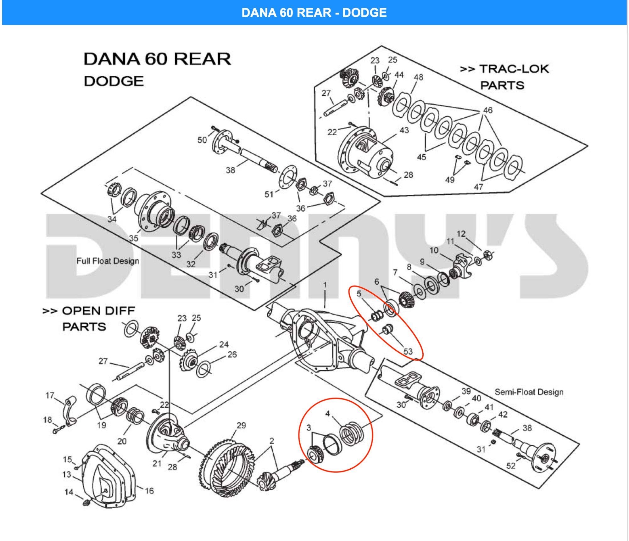

I installed the new bearings and races, tightened the pinion nut, and still have the same condition, about .050 of in and out play. Never having tightened a crush collar before, I figured I had to go more. So I got a floor jack under my breaker bar and jacked it up until I was just about jacking up the whole truck and the nut still wouldn't go any more. I bought a harbor freight 1/2" impact which is supposed to be 1100 ft lbs (Earthquake XT) and borrowed a big *** compressor and hammered the hell out of it, same thing. I watched people do it on youtube with an impact and they say how hard it is to crush the crush collar, but they go braap braap braap and it starts to get tight, and they say "time to be careful because crush collar etc...". I did a lot more than that. I'm convinced I'm bottoming out somewhere.
So I look at the shop manual and it only shows that one shim between the inner bearing and pinion gear (see pic attached). But if I look at Dennys Driveshaft's website it shows shims between the bearing race and the housing (#'s 3 and 4).
If you've had this rear apart before and someone wasn't in there monkeying around before you, can you tell me which is it? Where do the shims go? They also show shims by the crush collar, but I assume it's either/or right? Not supposed to be both?

Shims go between the bearing, and the gear itself. So long as you can get the correct pinion depth, and still have the bearing completely on the part it presses onto, shims behind the race aren't required.
The crush sleeve can take some serious torque to actually get it to crush. They do make crush sleeve eliminator kits, and I highly recommend going that route.
