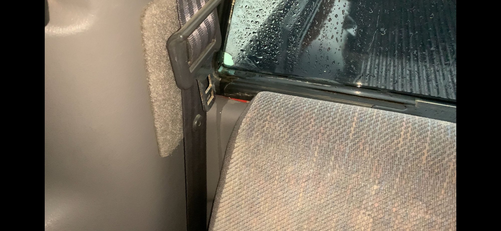

My backlite seems to be leaking from the parting down the middle, pooling up water causing it to soak my passenger floorboard. I’ve cleared out my drains, but it’s still leaking. Is replacing my backlite to a solid one my only choice now? Thank you!

mines doin the same thing, but u can only c where its leakin when its REALLY comin down outside. When I gutted my truck while doin heater core/bed liner-ing the entire floorboards instead of putting my nasty carpet back in, i also went around the entire perimeter (interior and exterior) of my back window w some clear silicone (minus the sliding panels of course). Didnt realize at that time where it was leakin in from yet. We both need the actual seals for the sliding glass pieces. Dodge discontinued them, and LMC only offers a kit for the single sliding pane, not the dual split....best bet is to custom cut some other type of window seal n test it out....soon as I get around to that I'll post on it....could b a while tho lol

Check the weep holes on the outside… if they’re blocked water will well up in the track and overflow on the inside.
Over the years dust and water make a mud that dries and blocks the drain holes.
