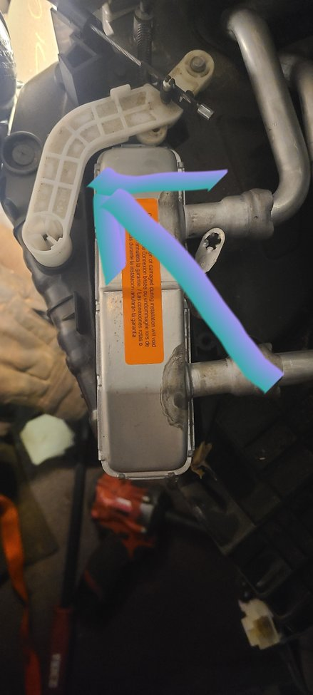

Originally Posted by Moparite
In my opinion jacking up the truck and buying extra stuff is just a waste of time/$ If you have the jiggler valve or hole drilled in the t stat air will get purged out as soon as the t stat opens. It's not going to over heat because the air is in the heater core/lines. Been doing this even with the LA motors and never had an issue but to each his own. I was wondering if you replaced the gasket material that goes around the ends of the heater core? There is none in this pic. Doubt that's the issue here but it will cause air to bypass the core and go around it. If i recall it's on the top/bottom and the sides.
You mean drill a hole in the t stat itself? No it doesn't have that and no I don't have this jiggler valve you speak of. And no sir It did come with any gasket I didn't bother trying to track down some for it. I can't see that being a big reason why the heat isn't great. Why do you think jacking the truck up and burping the air is a waste of time ?
You can easily tell if air is bypassing core by removing glove box and putting your hand up in there above core with fan on high.
We definitely have leaks around the '98 we did because that foam "weather stripping" is a PITA. You're still getting the heat into the cab, although it is poorly directed, inefficient and mostly behind the dash
Yes drill a hole like in post #14 and lifting up the front does nothing since the air is above the t stat and it cant escape through the lower hose. Lifting it will expel some trapped below the stat but the hole allows the air to escape from below and above the t stat. If you didn't put weatherstripping around the core cold air will just go around the core instead of heating it going through it.
I didn't weatherstrip the core. But the heat is Dan good right now!!
