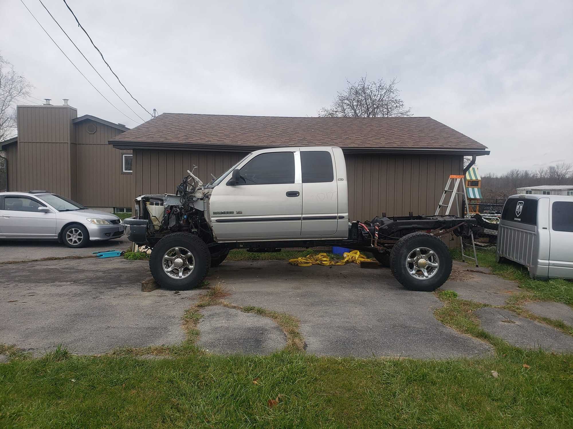

absolutely BALD BFG 315/70LT17 . Truthfully this truck sat for like 10 years in a driveway down the road from my house. It wasn't road worthy and still isn't. The truck needed a lot of work but I didn't pay a lot and it came with enough performance parts to justify the price if I decided the truck wasnt worth fixing. To my suprise, the frame was actually in excellent shape with only minimal rust. The body was rough. So far I've replaced both the cab and fenders with rust free southern parts. I will replace the box with a southern box when I find one that matches the cab to save me painting it. I have not driven it. I was just happy it ran after I swapped cabs. the truck came with a Mopar performance intake manifold and Ceramic coated headers. The headers are installed and I will be installing the new intake before too long. The truck also has a trans dapt throttle body spacer. When im done, I will have a 95% rust free truck. That is the plan anyway.

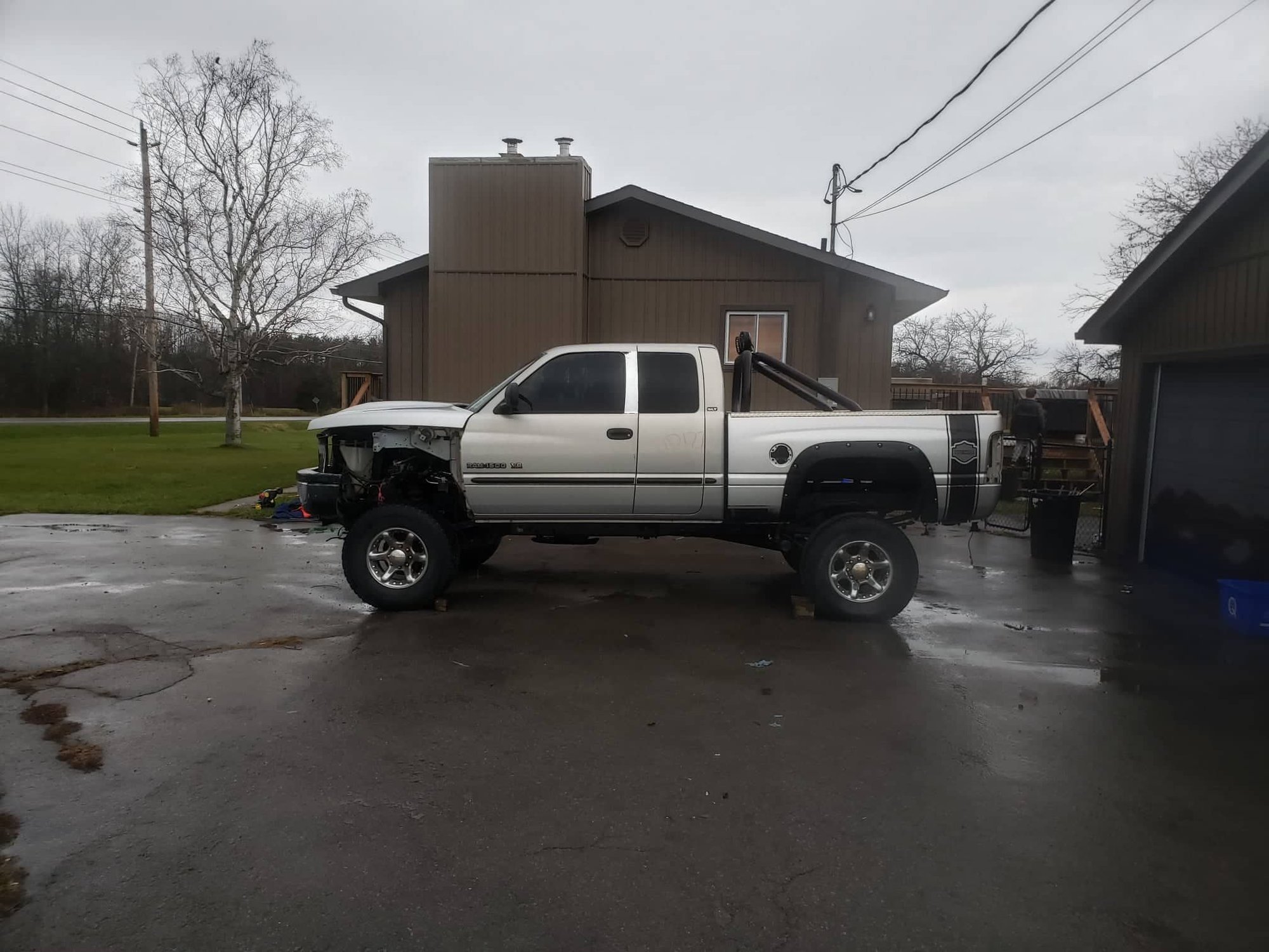

here it is sitting on the 3" body lift with whatever suspension lift it has. It not has a front end back on it
Old Feb 1, 2022 | 08:05 PM
Ramman18's Avatar
Ramman18
Joined: Feb 2007
Posts: 3,103
Likes: 109
It's plenty tall for off roading. Why do you need another lift? Just better performance?

I would like it to sit this high, only level and without the body-lift. Or less of a body-lift. When I was doing the cab swap, a lot of things are streched to the limit. I also wouldn't mind replacing the rusty looking parts that are on the truck currently and make it better at the same time.

If it were mine, I'd ditch the extra blocks in the rear and run stock back there. Then ditch the body lift and get new +3 springs for the front and new control arms and track bar. Done.
