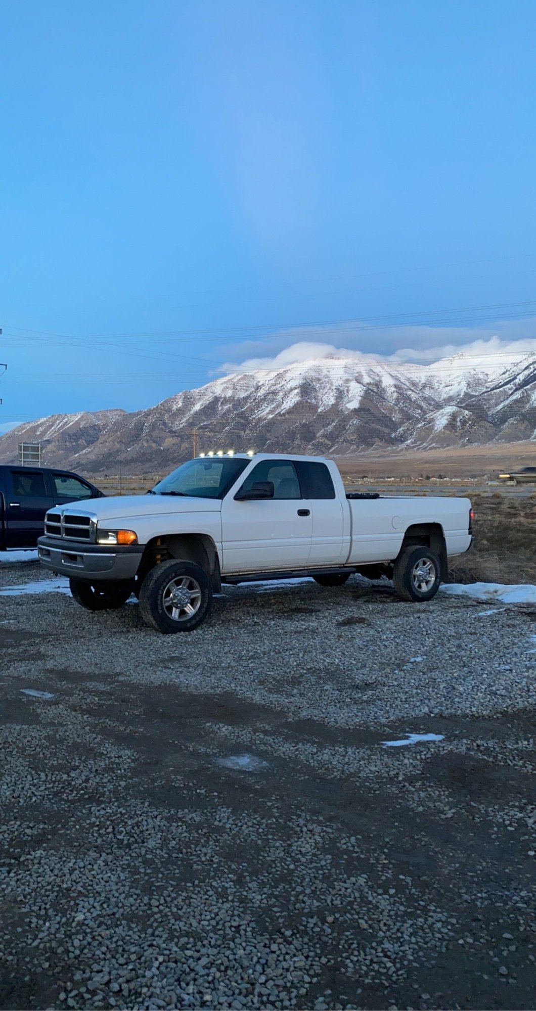

Hey guys, I致e got a 2002 Dodge Ram 2400 4x4 5.9 with the nv4500 5 speed. My clutch is toast, and 3rd gear grind going in, leading me to believe the synchros are shot. I figure if I知 going to be putting a new clutch in, I might as well put a new transmission in while I知 at it. I pull trailers occasionally, but not usually super heavy. The truck has BHAF filter, stock turbo, 75hp injectors, and a smarty tuner. I知 considering putting a bigger turbo in at some point, but nothing crazy. I知 wondering if anyone can point me in what direction to go with my new parts. I知 leaning towards a south bend clutch, but as for the transmission I知 not sure where to go. I don稚 want to break the bank, but I also want to build this to last me a long time. Any input is appreciated!

Looks like the SLV?
