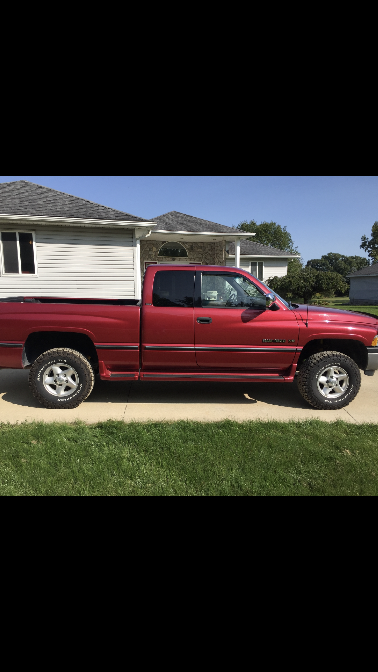

Are you the original owner of the truck? Given its age, no telling who has worked on it and what was done to it over the years.
Old Jun 21, 2022 | 12:29 PM
skevin's Avatar
skevin
Joined: Mar 2022
Posts: 74
Yes. All original only 80,000 lol. Not any rust in any panels. The old jolopy still runs
