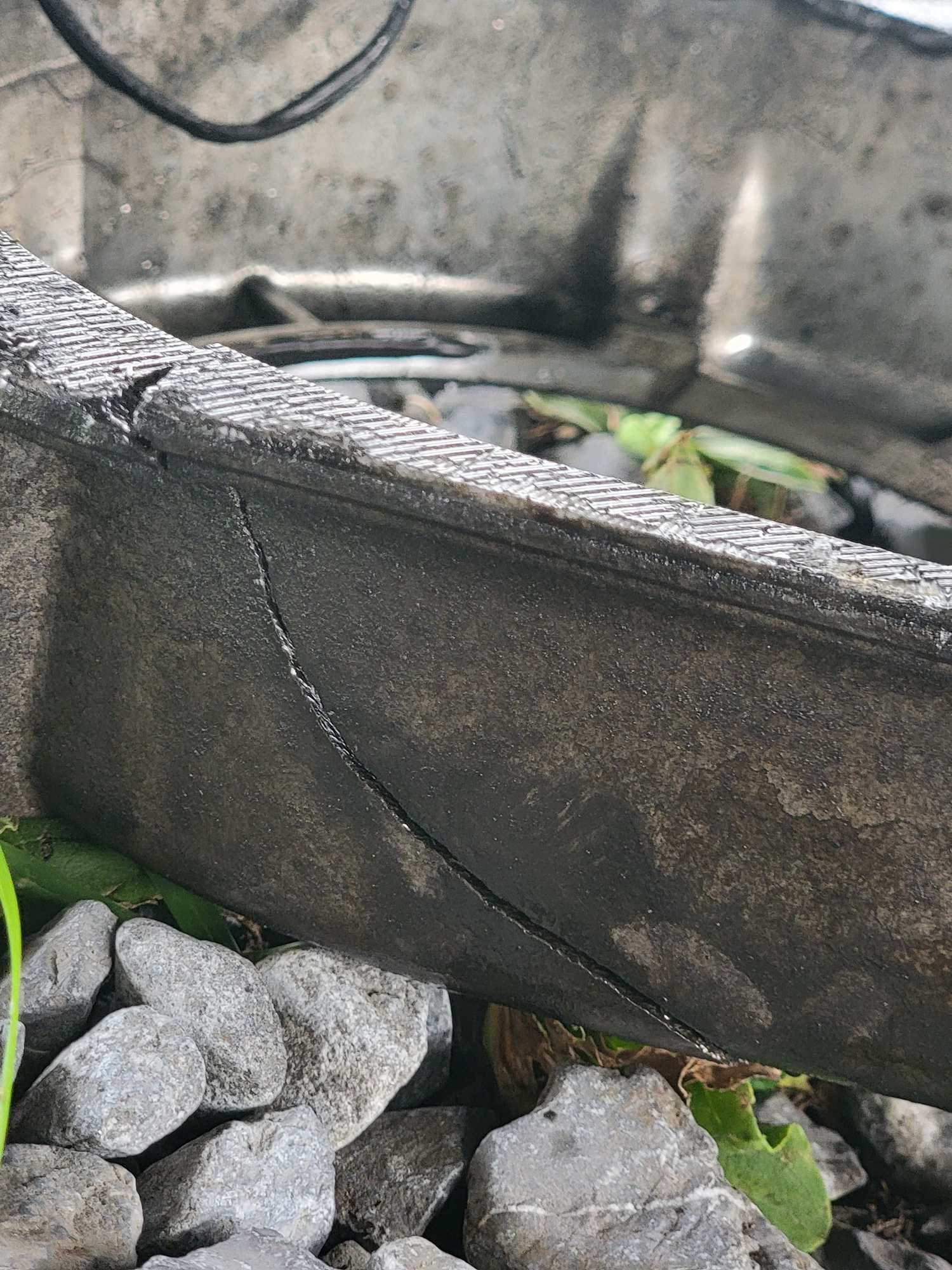

I belive a bad trans mount as the transfer case was hitting the floor of the cab really hard.

Ouch yeah if t-case was hitting body that would likely do it. These alloy case housings aren't meant for that kind of external abuse

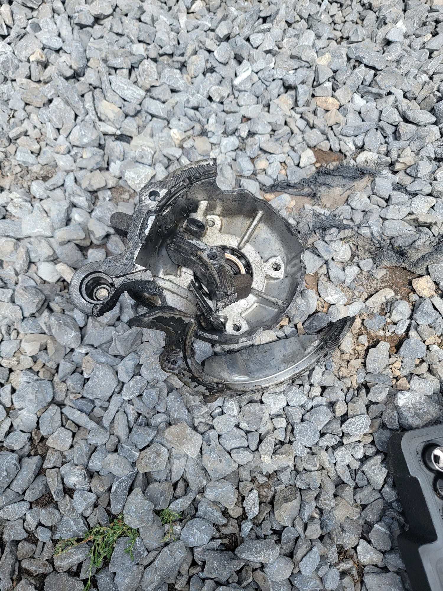

Here is what I found. The rear housing is ok and the output shaft isn't bad. The rear retainer housing is shot, along with the back case half. I pulled everything with the transfer case still on the truck. Some metal shavings in there but I will clean them out. Does the magnet go under the filter?

That seemed to have fixed the issue. Now onto the drive line vibration
