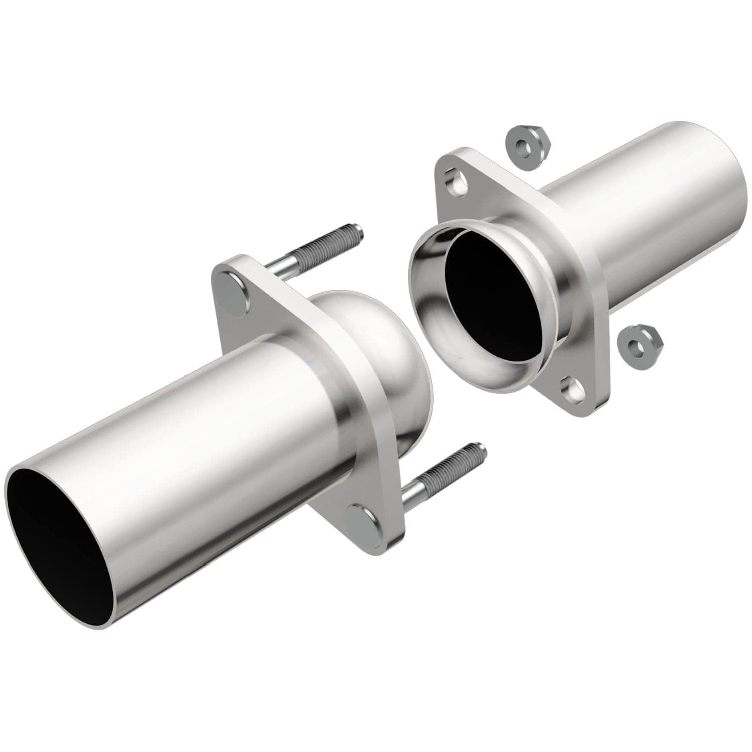

I believe it’s coming from the flange where the exhaust manifold/headers meet the y pipe. I tried tightening it but That didn’t work. Also I don’t think there’s a gasket between the exhaust manifold and the y pipe to the cat is there?
If it's not an exhaust leak it's probably oil/grease/antifreeze you got on it after the head swap. It should burn off and go away. No gasket, Just a ball flange seal like in the pic.
And i doubt that any rtv will last on exhaust where temps can go up to 1500. This is only rated at: (Temperature range -75F to 700F intermittent)
