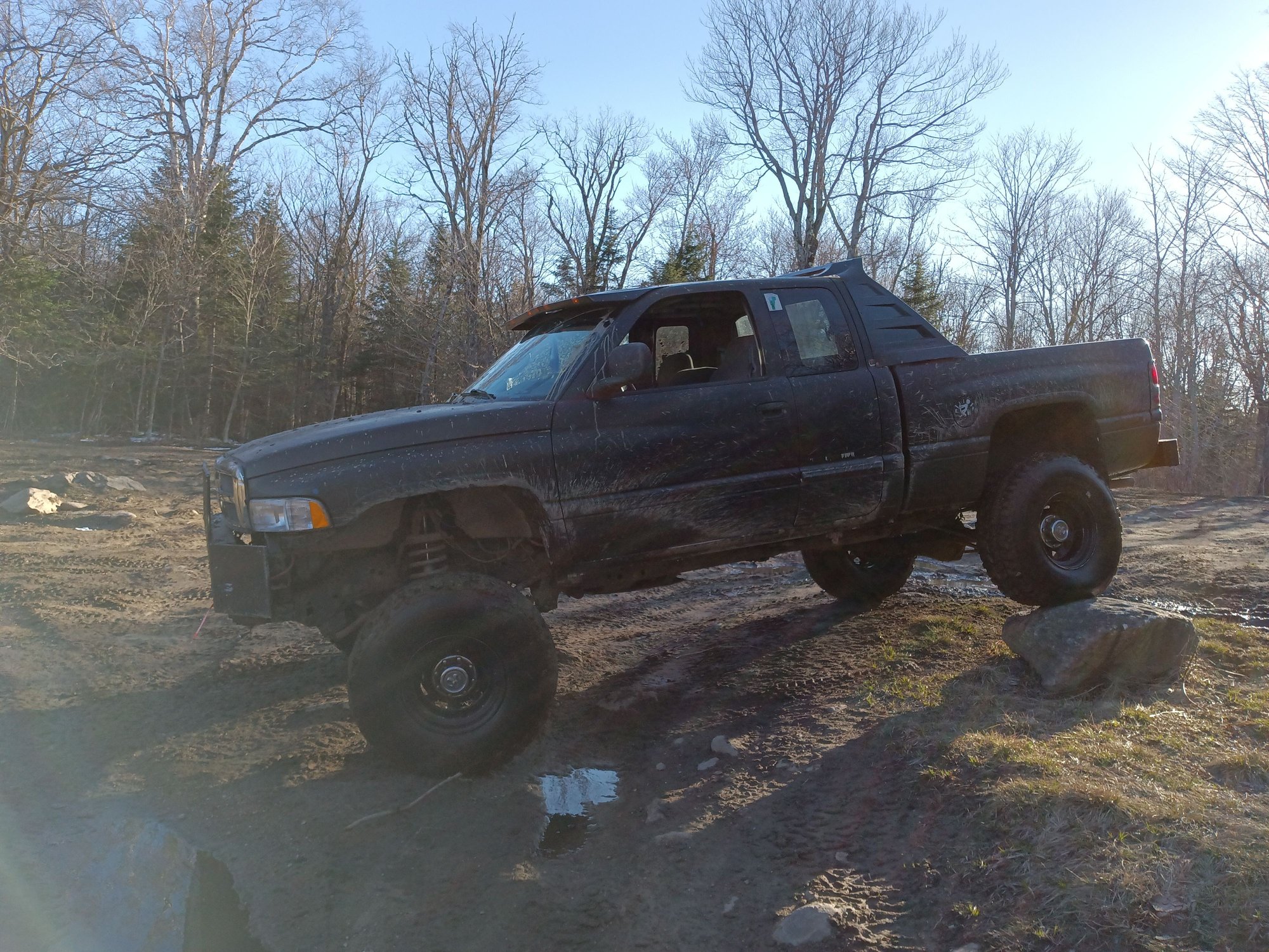

Definitely not a creampuff lol Truck is used primarily as a Toy for the woods. Or horsing around town leaving skid marks. It's only got roughly 200 miles on it since the build was done. But the exhaust manifolds been on the engine since before it came out of the doner truck. Probably original from factory..
Any tips besides for PB- Blast the hell out of it?
Here's a pick of My Baby
