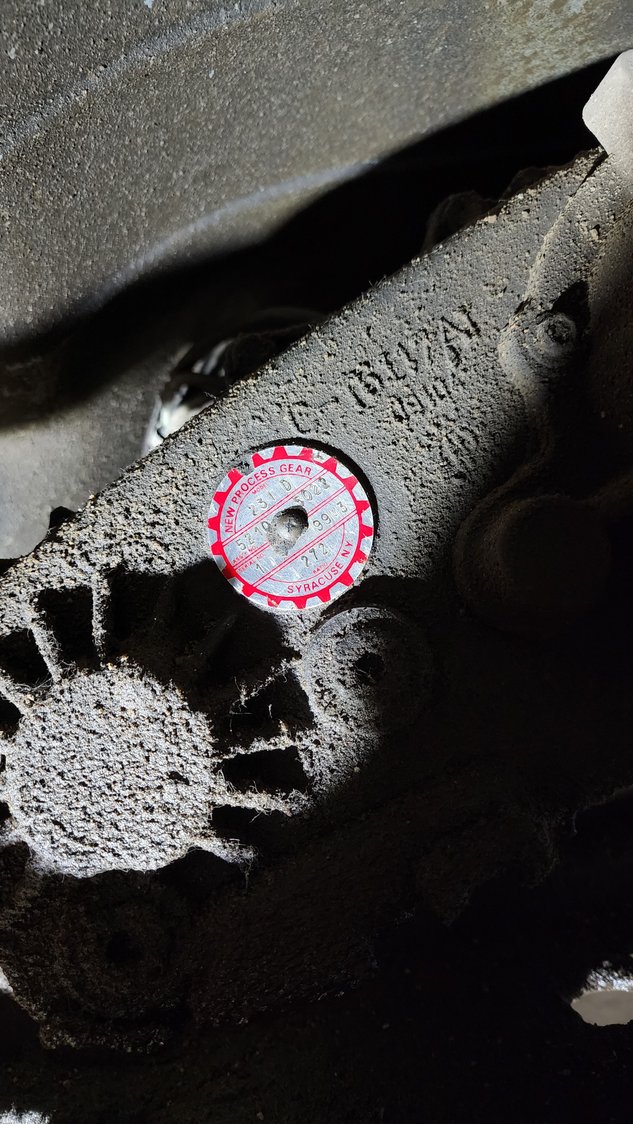

I got the O2 sensor off with the help of a pipe wrench and a hammer but it didn't seem to make much of a difference. I also checked each cylinder quick with a temp gun and they were all similar so I don't think I have a dead cylinder. I couldn't find any tags on either of the front or rear diffs but I did find one on the transfer case. Pic attached. If the ratio really is 2.72 then that may well be my issue. That would make sense because it runs down the highway at 60 at around 1500 RPM.

You likely have 3.55 gearing in your front and rear diffs. The ratio on the transfer case has no bearing on your overall gearing, which is determined by the ring and pinions in each of the diffs. They are likely 3.55, based upon your experience with overall speed at 60 MPH. Whoever changed the gear oil likely threw away the diff tags that were affixed to the cover bolts. The next time the diff covers are removed, the gear ratio should be stamped on the side of each ring gear in each diff.

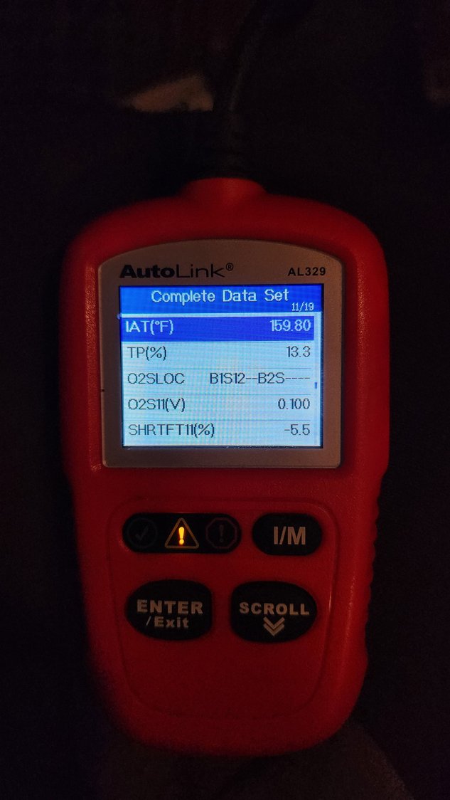

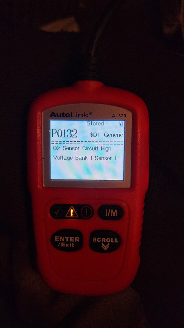

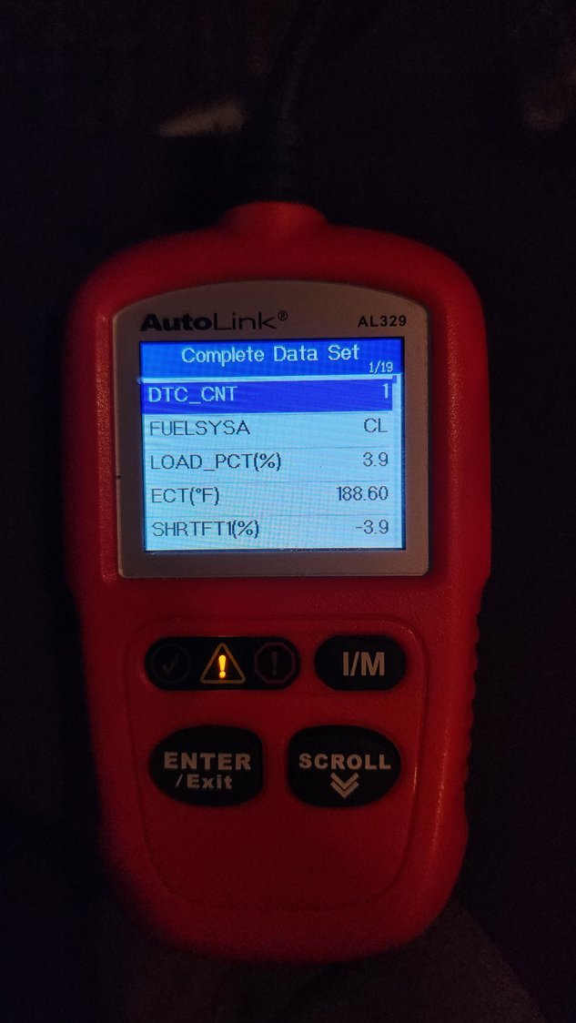

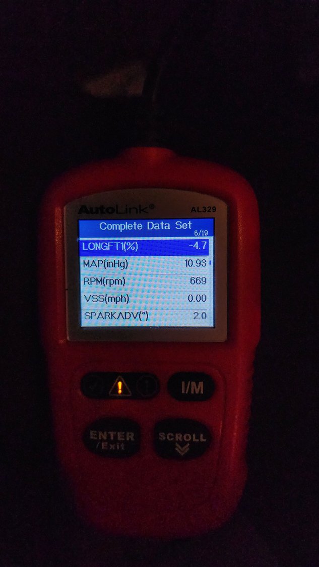

The truck has about 175,000 miles. I hooked up my scanner and took pictures of the live data at idle with the engine warmed up. I'll admit, I don't know much about what I'm reading here. I know the fuel pressure should be around 49 psi but I'm not sure why it's giving me percentages for those readings. ​​​​​There was a stored code of P0132 but that may have just been from when I disconnected the O2 sensor. I haven't unplugged the battery to reset since then.
