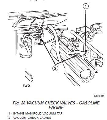

I'm trying to figure out my wild vent issue on my old beater truck. I have 2001 Ram 1500 5.2L 4 X 4. My vent has been stuck in the defualt positions for about a 1 year. I've read a lot of the post on wild vent issues. I just installed a check value and I noticed a missing/broken vacuum line and I have no idea where it should run to. I don't see anything hang on that side of the truck. Where does the circled vacuum line connect to? I assume the X lines runs to the vent? Thanks in advance for you help.

X runs to the reservoir, O is the line going into the dash and the line in front of the CV is for the cruise control. This pic is for the TSB that was for the earlier trucks that didn't have the second check valve. You have the large one so it shouldn't be an issue. If it is put a another check valve on the O line. Also make sure you have the check valve installed the correct way(it needs to hold vac towards the O line).

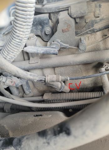

What is the check valve between motor and fire wall? Seems to go down to tranny. 97 1500
Is your truck a 4x4? If it is, then those lines are likely for the transfer case, and central axle disconnect.
it is 4x4

Should be a white, and green line heading down there. White is vacuum supply for the CAD, green is just a vent line, doesn't hook to anything up top.
