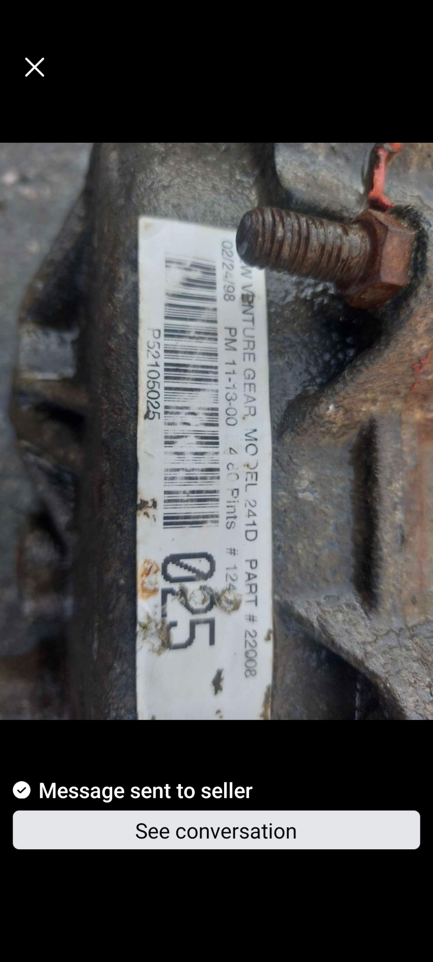

The used Transfer case is a
1999
241D
PM 11-13-00
22008
025

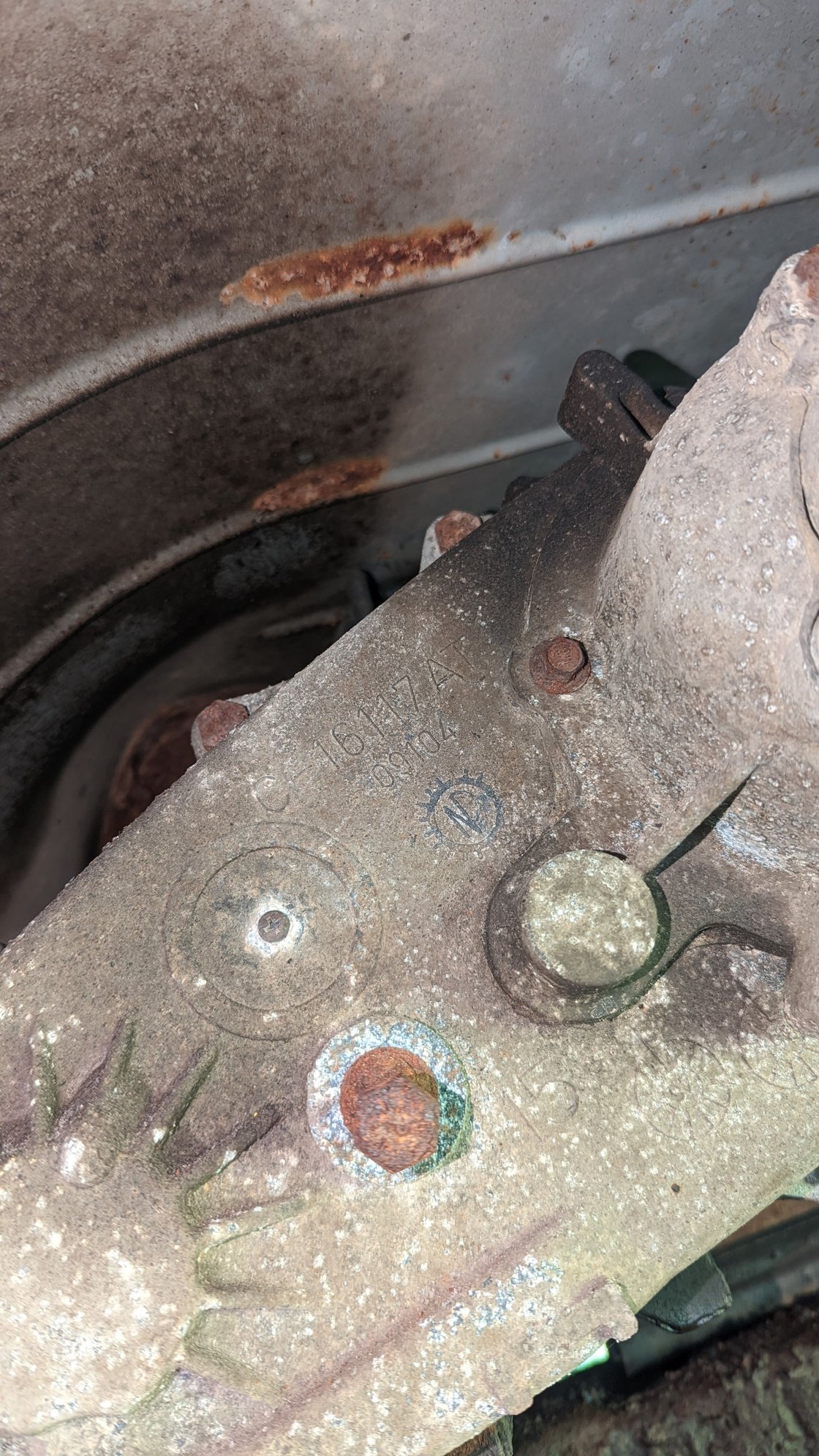

I'm not sure what mine is.
Vin # 3B7HF13YXYG147250
My Tcase
used Tcase

Old Sep 15, 2022 | 12:56 PM
Posts: 87,572
Likes: 4,233
Vin decoder from FCA says: Shift-on-the-Fly,231HD Transfer Case
You have the DHD t-case. The 231D will be an inch or so shorter..... so, rear driveshaft length is going to be an issue.

Old Sep 15, 2022 | 03:50 PM
Posts: 87,572
Likes: 4,233
Splines should be the same. Should be able to use the drive shaft from the t-case donor, assuming it is the same cab/bed length as yours.
