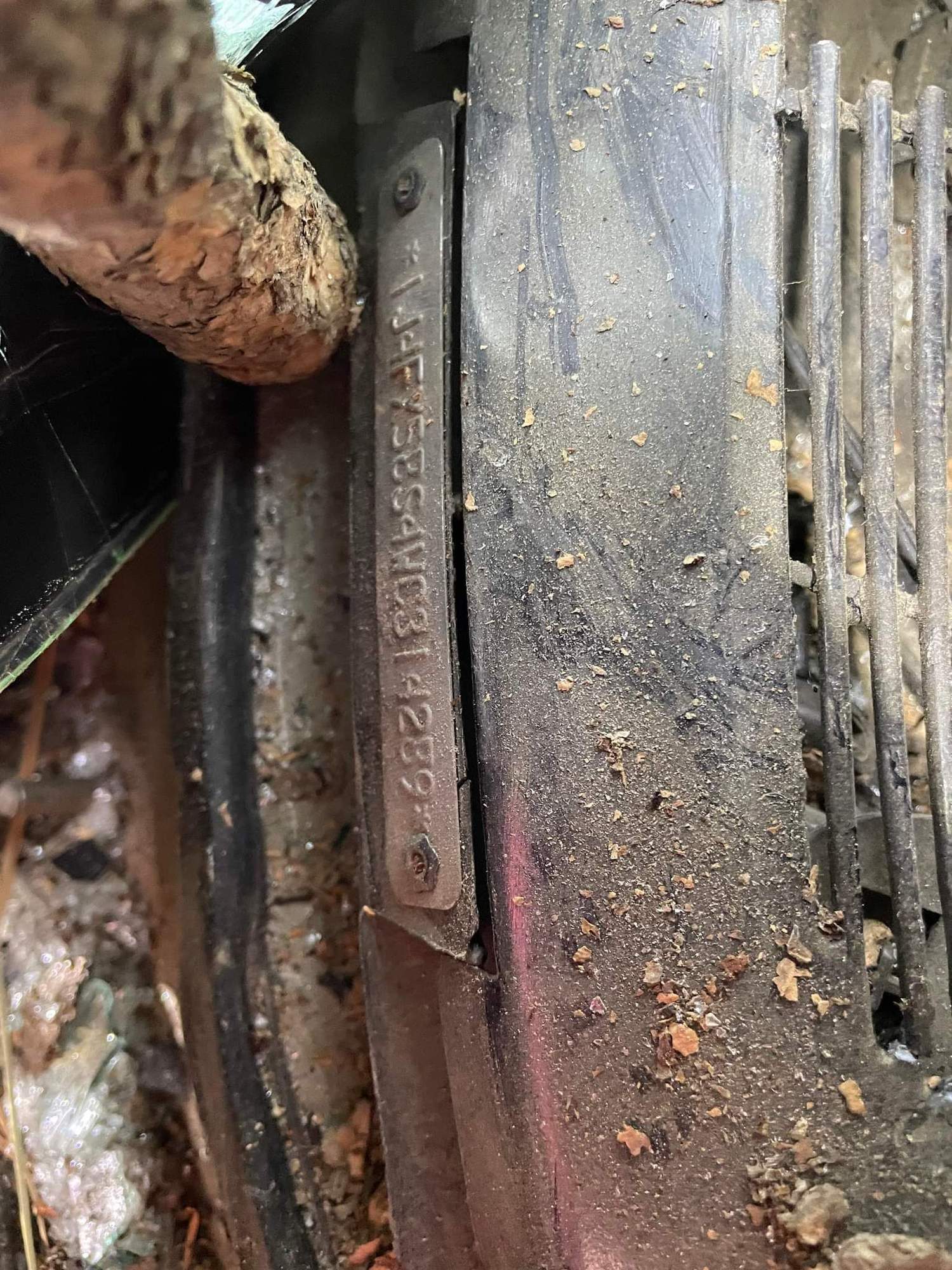

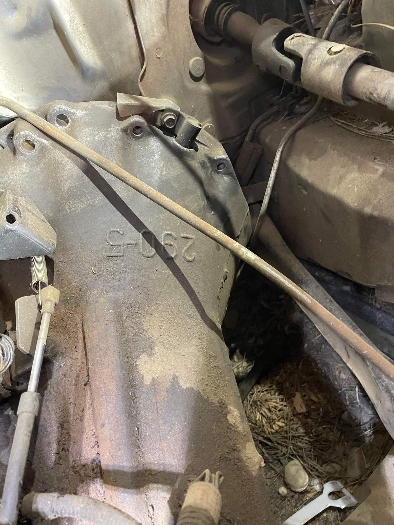

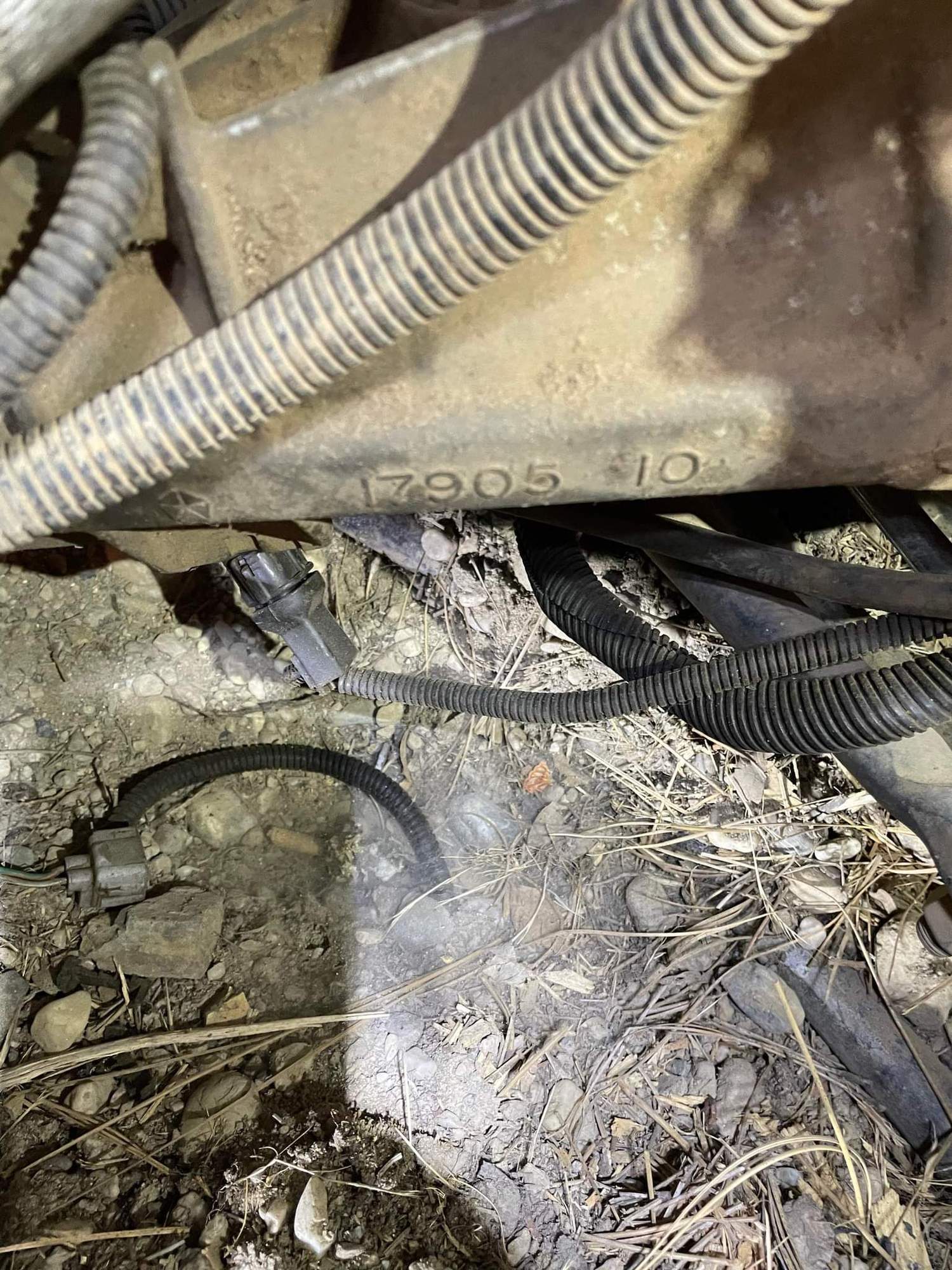

I'll upload pictures of the jeeps trans numbers , they looked identical. ? Pretty certain it was a 42re or 46re. But I could have my head in a bucket too at this point.
Vin of the jeep

I suspect that you pulled the wrong valve body out of the wrong transmission and won't work properly with your 46RE. If I ran the VIN correctly (https://www.vindecoderz.com/EN/check...FY58S4WD314289), seems that you pulled it out of a 4.0 motored vehicle, which likely did not have a 46RE transmission.

Well it was from a 4.0l , but they have practically the same valvebody if I'm correct. 42re and 46re difference is strength of parts and versions being small and large pump holes. And of course plug types 3 pin or 4 pin. Which I swapped for mine. My guess is the stupid metal barrel piece that I missed is the problem . (But not a clue where it goes. ) And/or the pump hole size difference for the 46re requires the large hole version. 😶
