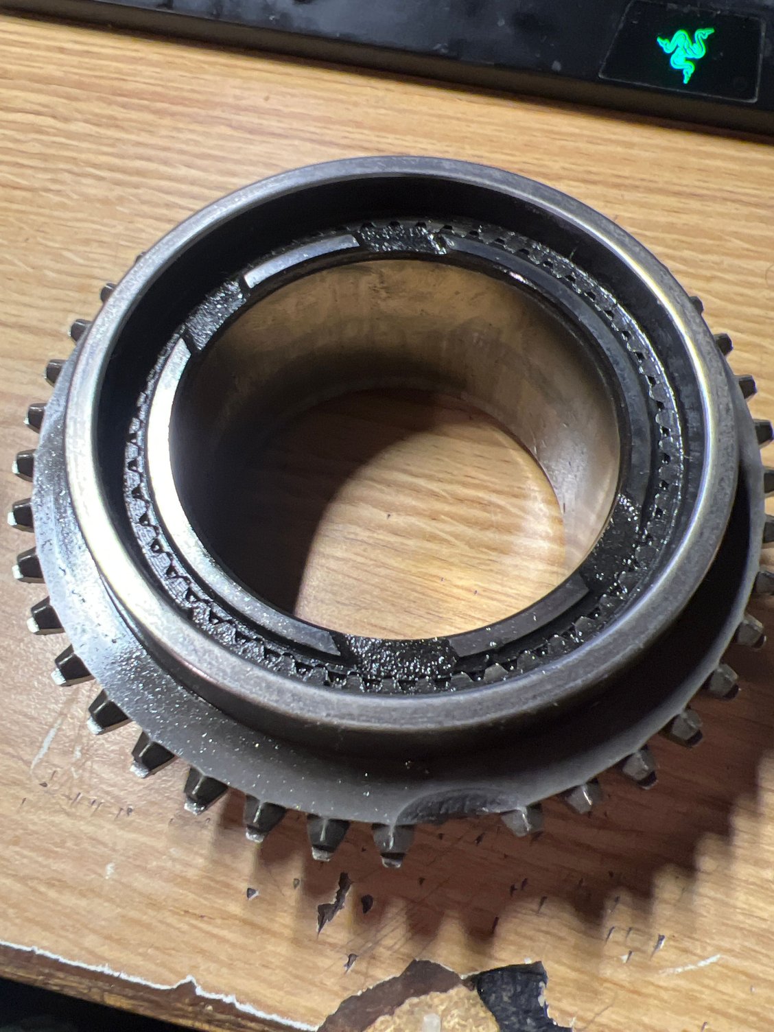

just tried to call them and they dont make it anymore, or have any available. The teeth on the gear are find it’s just one of the smaller teeth on where the synchro slider would slide into that’s missing, what are the odds I get away with putting it back in that way and being alright?

Post a pic of the gear in question?

you can see the tooth missing, in my head since it’s not a gear tooth maybe it could be filed down or something to get rid of sharp edges and it wouldn’t be too much of a problem but I’m in no way an expert on the subject or anything, hence seeking advise lol
here’s the synchro side

If you can't find another one... you may not be left any choice but to re-use it. Clean it up as best you can, smooth out the wrinkle there as well.
Is that syncro ring just pressed on to the gear?? Wonder if you could just replace that......
