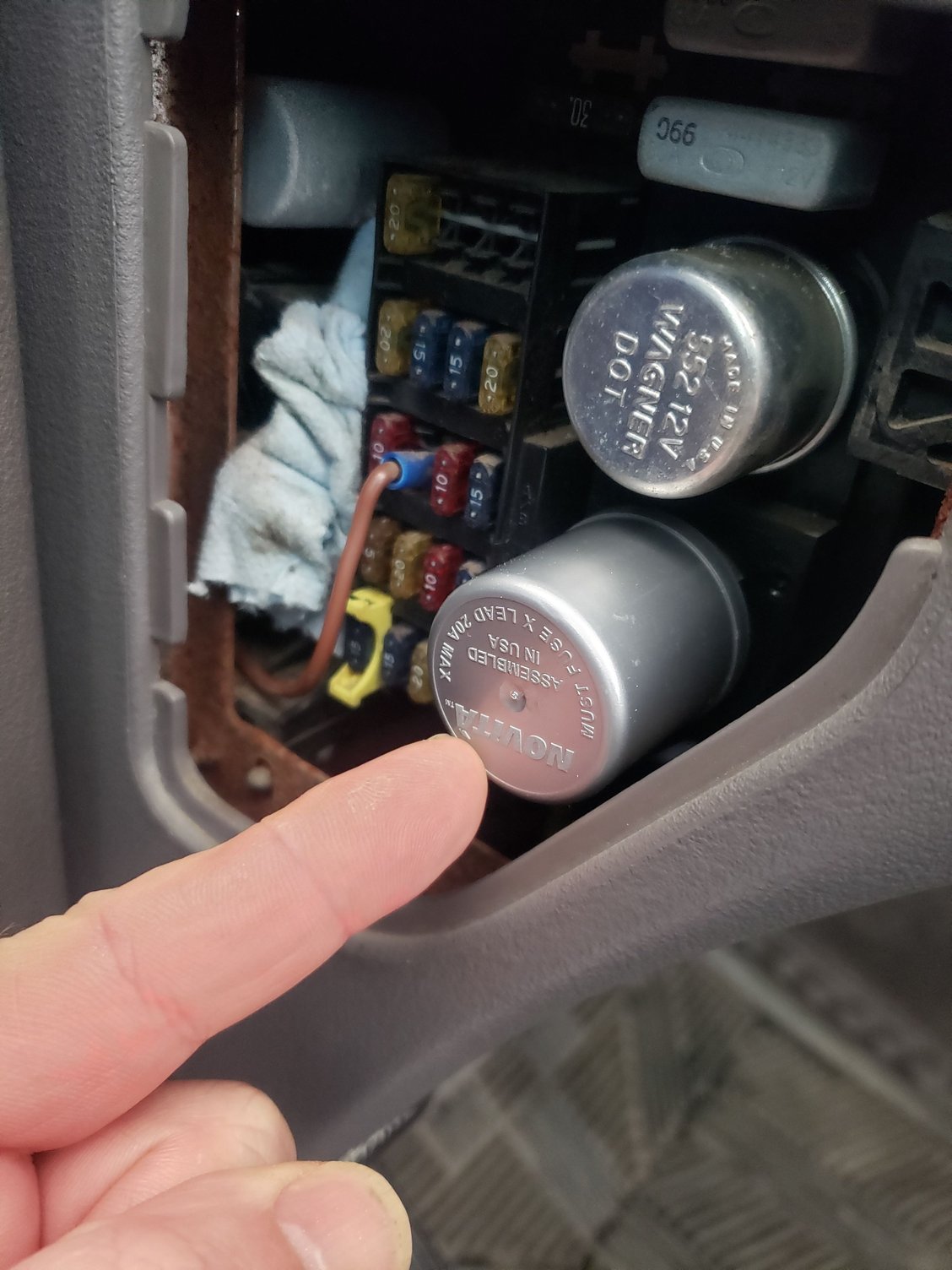

The turn signals had a blown fuse. The turn signals are operated by a round fuse in the fuse panel on the driverside dash. Open the diverside door and you will see the plastic door that says fuses. There are 2 round fuses. The top one operates the hazard flashers and the bottom operates the turn signals, they are the same fuses. In my case my hazards worked and my turn signals did not. So I removed the hazard fuse and installed it into the turn signal fuse port and the turn signals worked. Simple fix! $10 @ O'reillys.
96 Ram 2500 V10 fuse panel driverside dash. Top round fuse works the hazards and the bottom one works the turn signals. Super simple fix!
Thanks HEYYOU! I can see @ night now and my turn signals work! Nothing like roll n the wind down when its 5 degrees out to use hand signals! Fantastic advice!
