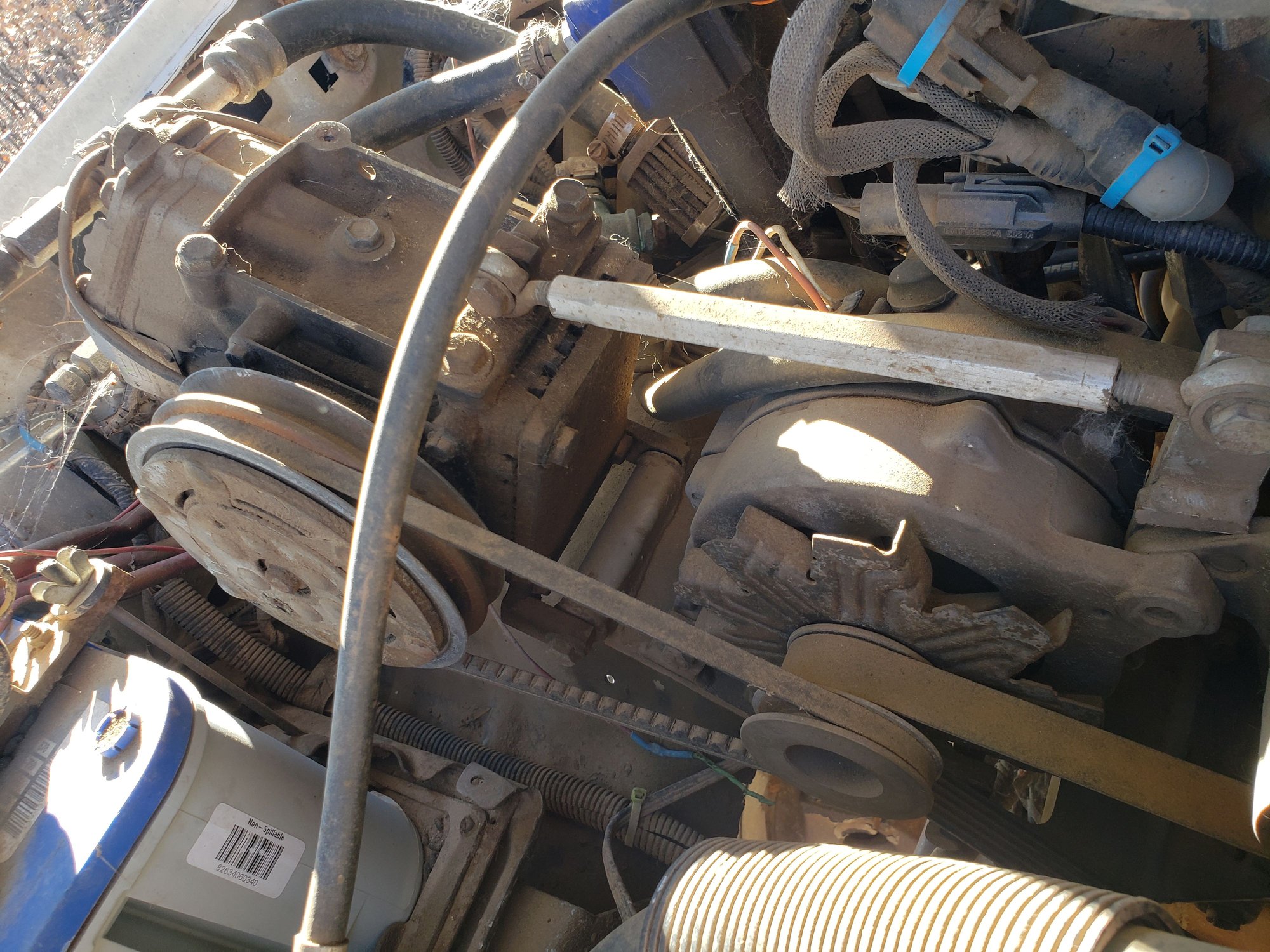

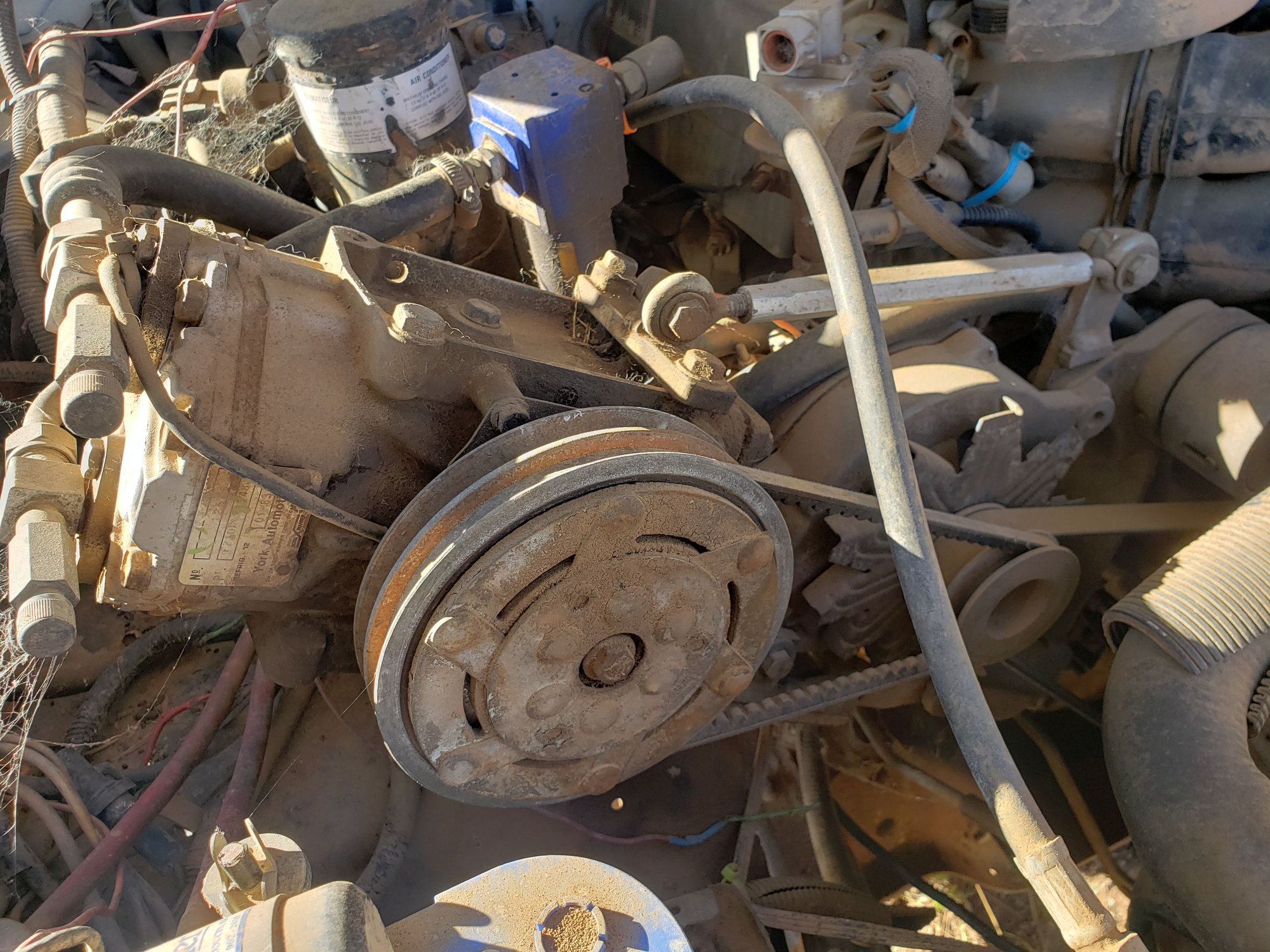

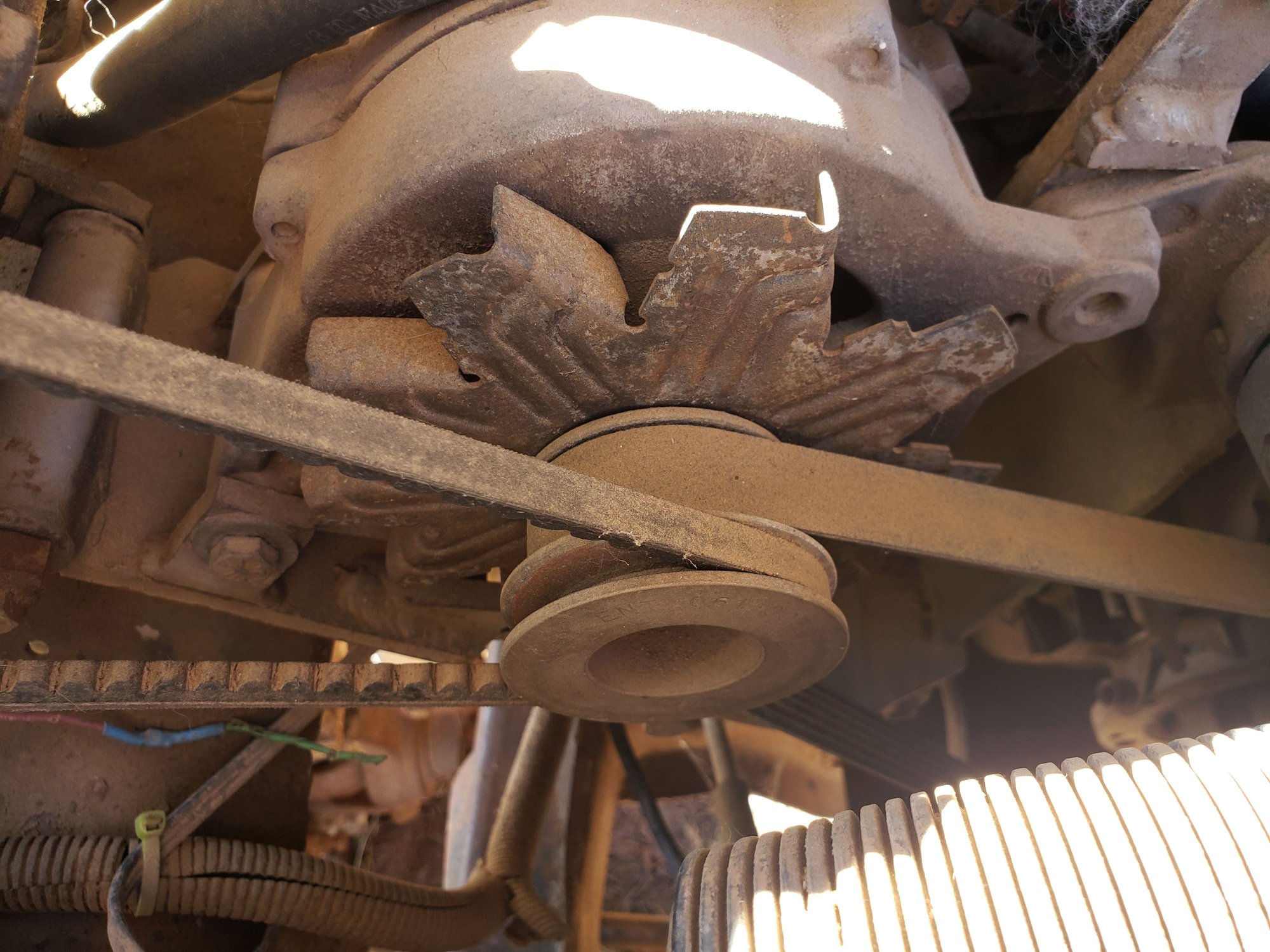

Here was my old school York install on an EFI 351 OBS Ford. Yorks are riddled with tapped holes all over so you have to work to find a way NOT to mount it
