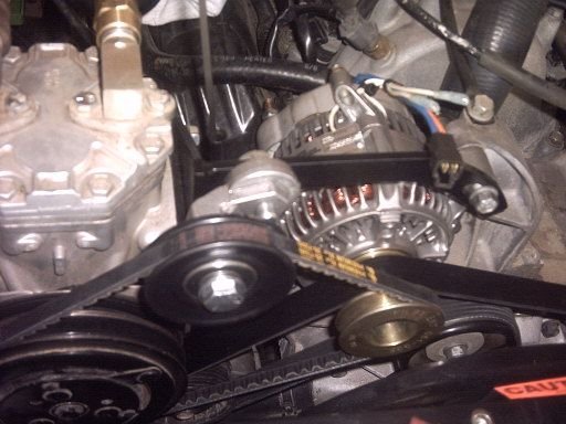

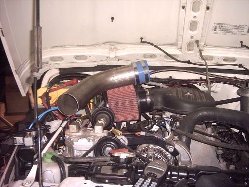

Originally Posted by Keith_L
This is what I showed in Post 13. The cheap hardware store turnbuckle worked great to tip the whole compressor and tension the belt. Seems more straightforward and compact than that additional idler way up high, but I'm assuming there was a good reason for it
Mine wasn't tilted that much. And if I remember my reading correctly the York doesn't have as much output when tilted or on it's side but I'd have to find that article again.
There isn't as much room under the hood of a Jeep also which would be one big reason why the brackets were designed the way they were. And that idler isn't really way up high. It doesn't sit any higher than the air hat .
It's barely higher than the top of the York.

I don't recall ever hearing of output changing with angle but there were arguments it didn't lube itself as well at severe angles. I never had a problem. My buddy crammed one in his XJ and it's horizontal (shrug).
The word "tip" apparently confused some. You of course wouldn't have to tip it very far at all to tension a belt if other simple factors changed like belt length and turnbuckle length.
With just a tiny bit of engineering you should also be able to just come up with a simple "pry bar" system, ie pry the compressor until belt is snug and then tighten a thru-bolt. Heck, even my '88 Ranger with 2.3 used this to tighten the primary belt and it was serpentine......Step 1: pry alternator Step 2: tighten bolt

I don't remember where I'd read that about the reduced output if on it's side . And yes the pry bar method is what I'd done on my old CJ. It's too bad the company that bought Kilby doesn't offer the brackets for the 5.2/5.9. While there wouldn't be a ton of demand I bet they'd still sell some.
If anyone wants I can take better pictures of my brackets. There was a thread on one of the off-road forums where someone had devised their own brackets for our engines. I'll look and see if I can find it. I've had OBA on all my 4wheeling rings now for over 20 years and have used a York each time just because of the output compared to other units.
