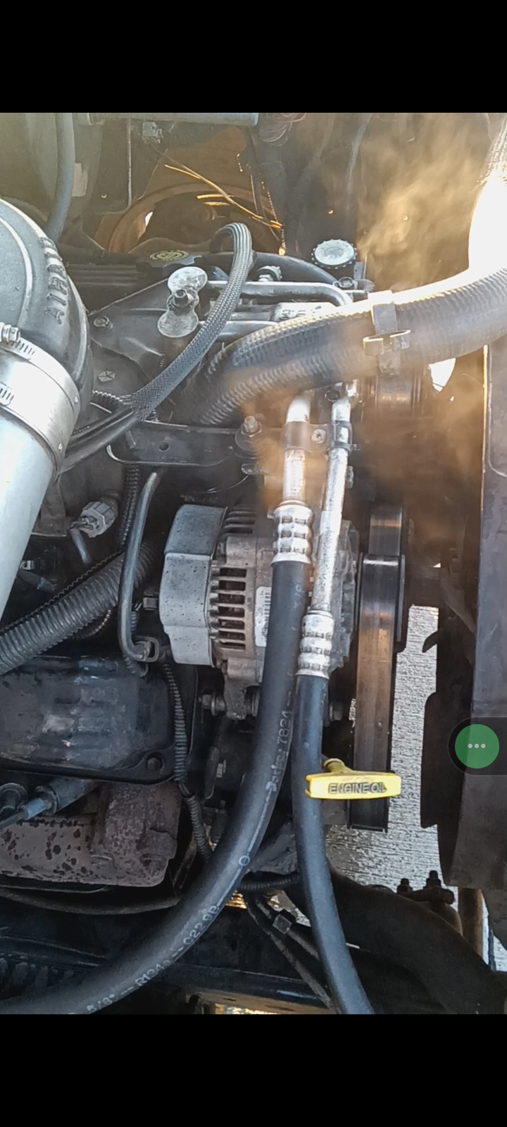

Oil looks fine. I don't know what to do it keeps overheating and there's pressure in my radiator hose. It's "spraying" out by the thermostat housing i think it what it's called. I'm going to try and upload a video.

Like the thing you unbolt that the thermostat is under. That's where it was spraying out.

Check the thermostat housing to ensure that it's properly seated/sealed at the base where the thermostat sets. The thermostat housing also tends to rust over time, so it may need to be replaced (small hole in it). Also, check your bypass hose that comes off the front of the intake manifold and connects to the water pump. The hose may be cracked or the clamps aren't tight causing a leak in that area.
