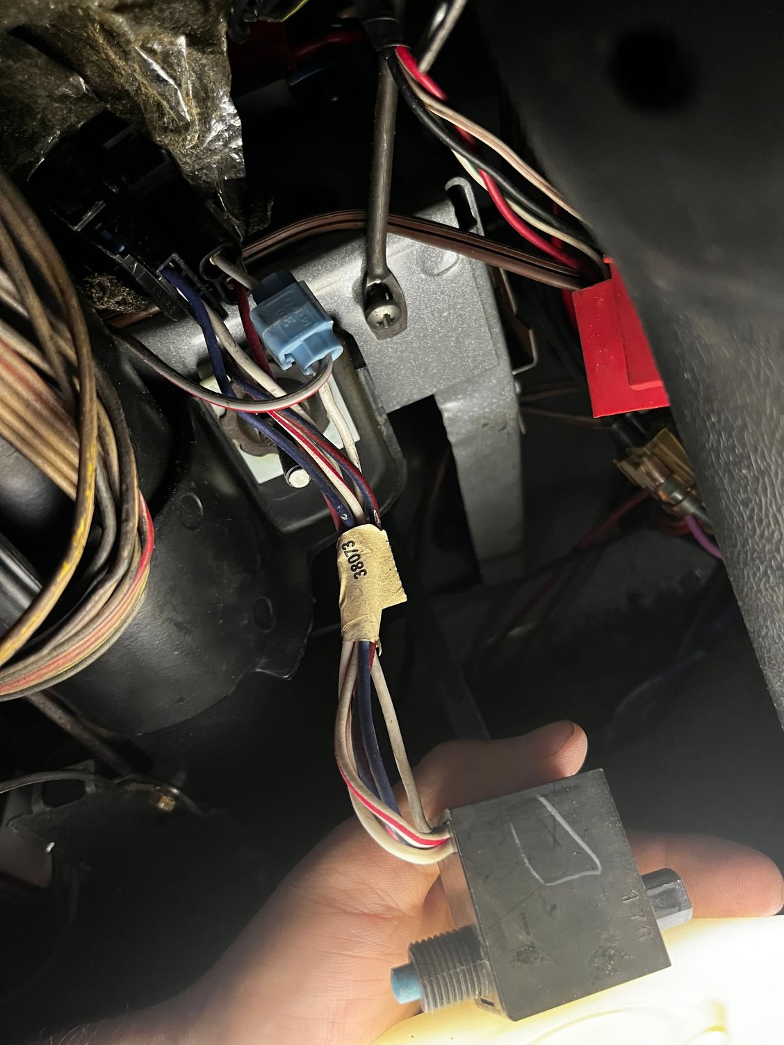

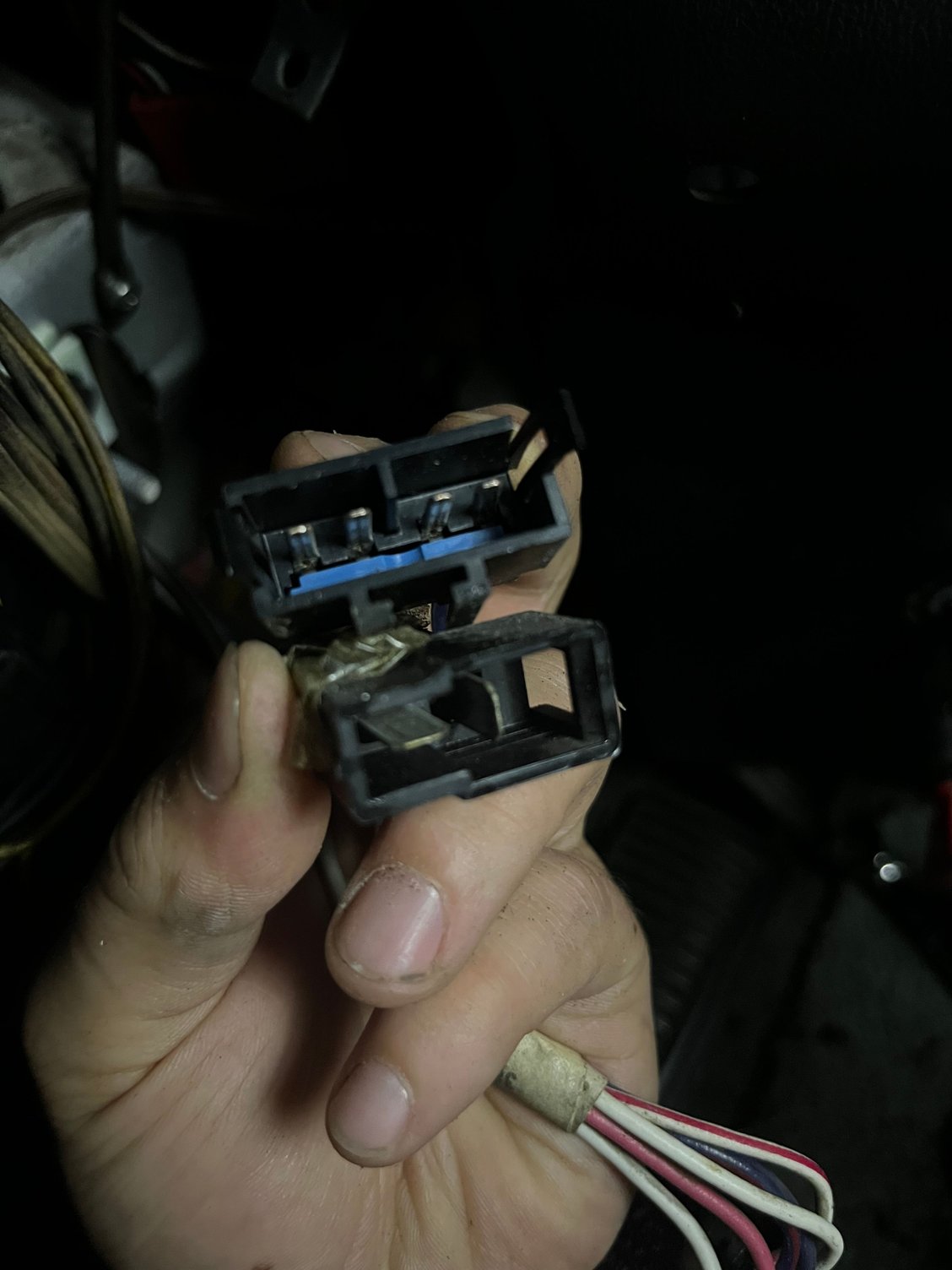

Hi do you have idea where I can find this exact brake light switch? I’m having a real hard time finding the correct one with the proper connections.
my rear light is stuck on and my rear blinker works. Left rear brake light flutters barrily and no left blinker. I suspect maybe a ground issue too. But I’m trying to go ahead and replace the brake light blinker but I fear I will have to modify some parts to get it work. Any suggestions?
Any idea where to find replacement
Brake light switch in 1986 dodge b250 v8 5.9. With the tow package.

I believe your truck is a 1st gen Dodge and the question should be posted there, however, I believe the brake light switch is located behind the brake pedal arm, The switch comes into contact with the brake pedal arm to control the brake lights. If the truck has cruise control, try Standard Motor Products SLS77. Without cruise control, check out Wells Vehicle Electronics 1S4981. Both can be found via RockAuto.com.
