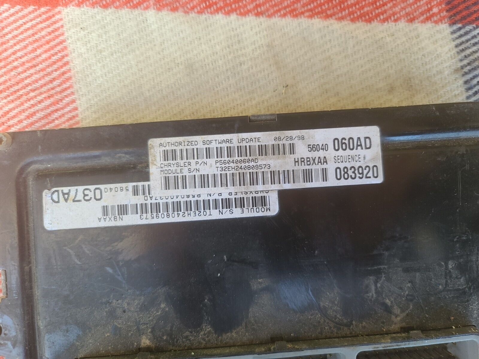

where would that be located?
Here is an example of the sticker with the part number that starts with "P5604" in this case. If you can find one that matches your existing PCMs part number, you can be pretty much assured that the PCM will run your engine properly, if the PCM is good..
