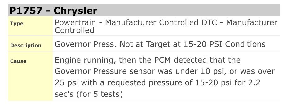

99 ram 1500 4x4, i have one code shown in the photo below.
sometimes the truck shifts perfectly, drives like nothings wrong, other times it won’t go down to first at all but will go down to second manually. Sometimes it will shift to first and second manually. This code keeps coming back but it has brand new electronics fluid and filter. Just can’t figure out what is going on.

Still the original governor pressure sensor/solenoid? If so, change em out, get the Borg Warner HD solenoid kit. Adjust the bands while you are in there.

I got it on Amazon with new wiring because my transmission was for a 00/01, I got it on eBay, it was sold by shiftrite. The fluid that I was using was the wrong stuff so it’s possible that the fluid clogged the solenoid and or sensor and is throwing everything off but it had been running just fine for a while

Should be golden there then. Do you have a scanner that can read live data? If so, see what governor pressure is doing as you accelerate.
