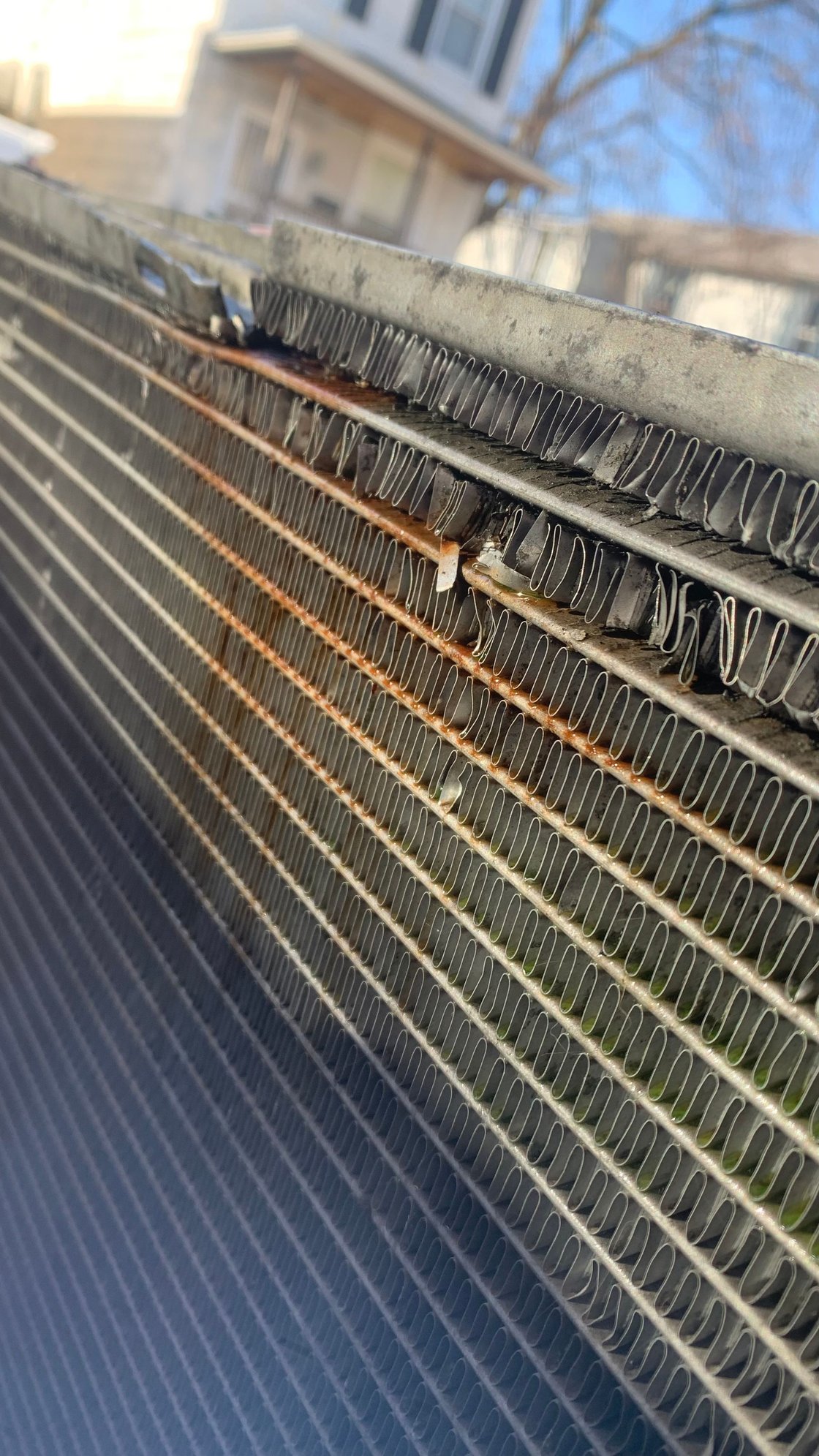

It looks about the same as the other one, Again it doesn't say what the width of each row is. Still want to see a close up pic of the rows.
The more expensive one is 6061 vs 5052. Probably wont matter.

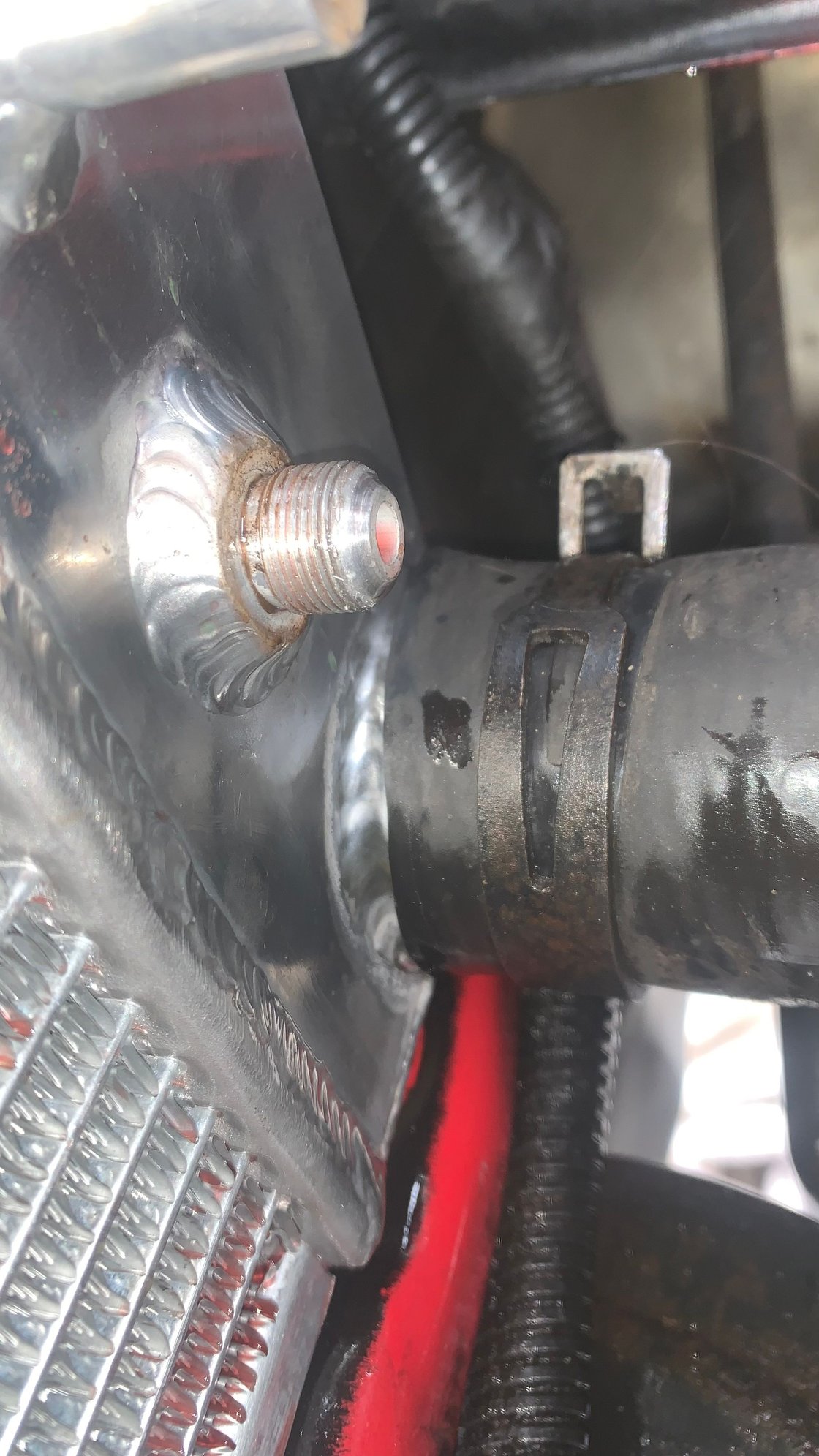

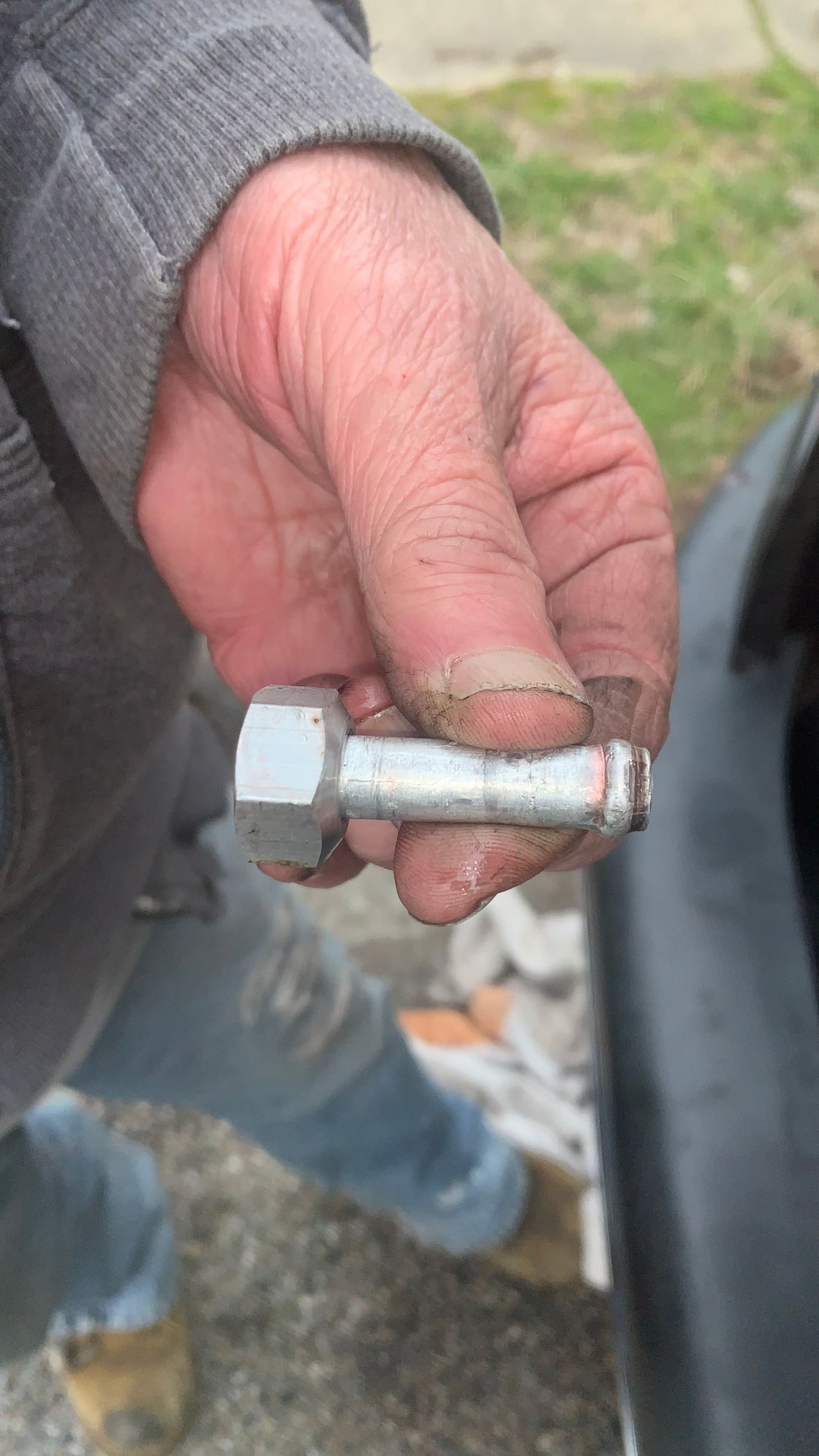

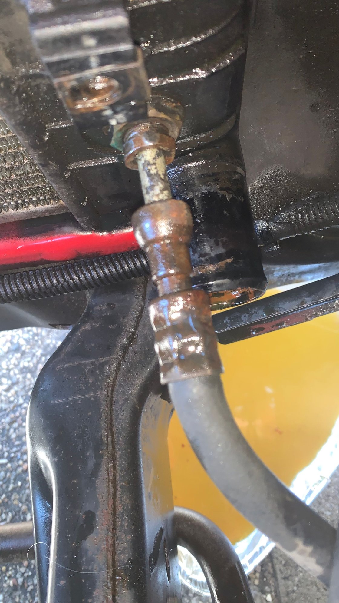

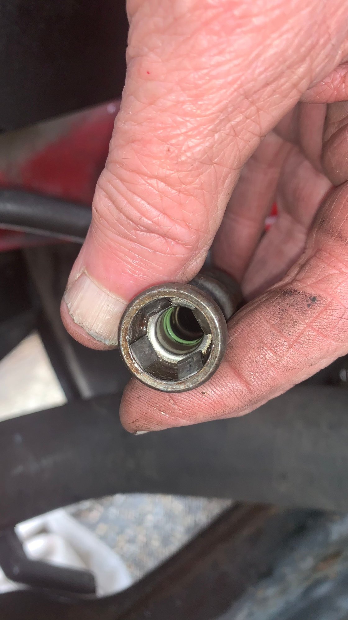

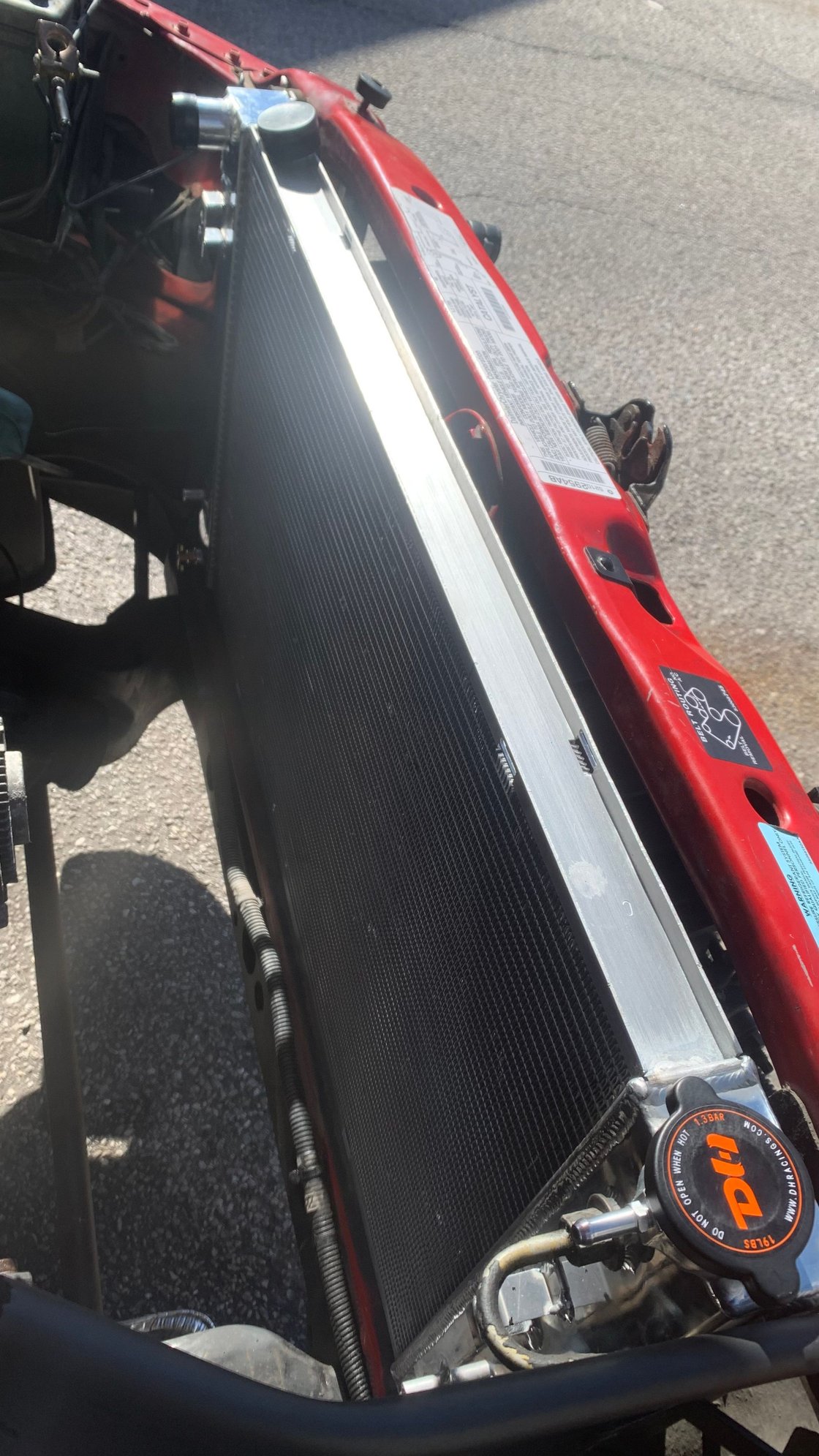

Hey everyone! Radiator install went pretty well. I haven’t installed the E fans yet. I’m having 1 pretty big problem that’s quite annoying and I’ll add a bunch of pictures.
my lower transmission cooler line just WILL nkt connect to the pieces they sent out. I messaged the seller on EBay and currently waiting for a response. Probably respond tmr.
I thought it was connect, test drove it very very little just incase something was wrong. Luckily I didn’t go far because the line popped off and there was transmission fluid EVERYWHERE. Dropped 0RPM Shut itself off. Luckily I was still parked out front of my house.
In the event that the eBay seller doesn’t respond. What could I buy to make this work? Some DIY ****. Lol. Adapters or anything. I have a BUNCH of my seasonal work coming up and I really need the truck running. It was running normal before with the RAD leak but it began squirting fluid across the engine bay and leak just kept getting worse so me and dad decided to finally install the new one that’s been in my basement for like a month lol. Any ideas will help. Sizes. Diameters. Whatever it is.

Is the fitting the right size? I believe they are supposed to be 3/8ths..... Might try using the disconnect tool to open it up, and the push it on... See if it will lock in place.

That fitting looks like it's for a hose to go over it not the quick disconnect. Probably need something like this to run the quick disconnect.
yeah we figured that out, sadly the hard way. We just cut it and clamped it on. Running great now! My truck went from 171-175 fo 167-171 temps… normal?

Yep, that's right about where ya want it.

Any chance you can post a close pic of the "rows"(front to back) that they say it has? If it is what they say it is i may get one.
