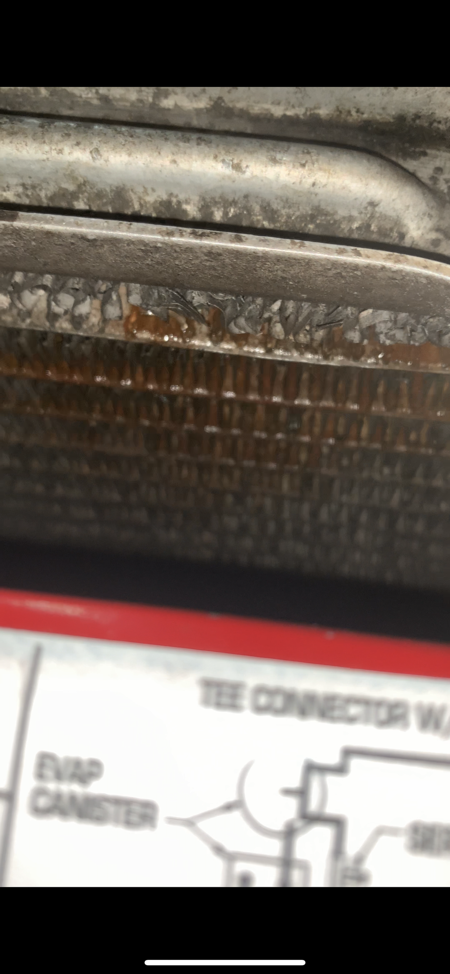

Guys, it’s beginning to fail on me lol. As I said, the top was already terribly broken, it just finally gave out. I drove 2 hours to hangout with a friend I haven’t seen in a while. Found this when I got there, wasn’t there before. I got home okay today. It’s not fixed. Going to buy the 3 row and shroud on eBay this Tuesday.

Keep in mind the oem radiator has a 1 inch thick "row" so you need at least 3 X .333 to equal the stock radiator. Have seen them advertised as "3 row" and each tube is about a 1/4 inch witch is less cooling that stock. Also be sure to count the rows, Aftermarket radiators rarely ever have the same amount as stock usually less(same with heater cores).
Hello! It’s 0.57in per row. A total or 1.71in or so the seller says
