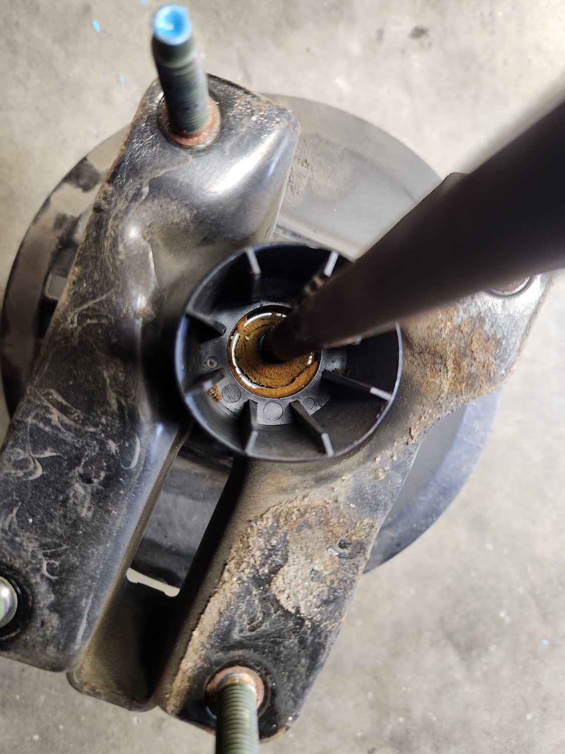

Installed new parts yesterday, including the master cylinder and booster. All went well and easy but the bench bleed took awhile.
The pedal is much firmer now, almost too much. But the brakes feel strong and work much better. Not sure if it fixed the issue with sinking pedal as I only drove around the block a few times. Vacuum seems strong.
Didn't have to bleed the wheels. The bench bleed worked well and the lines went right on without issue. Pretty easy job in all.

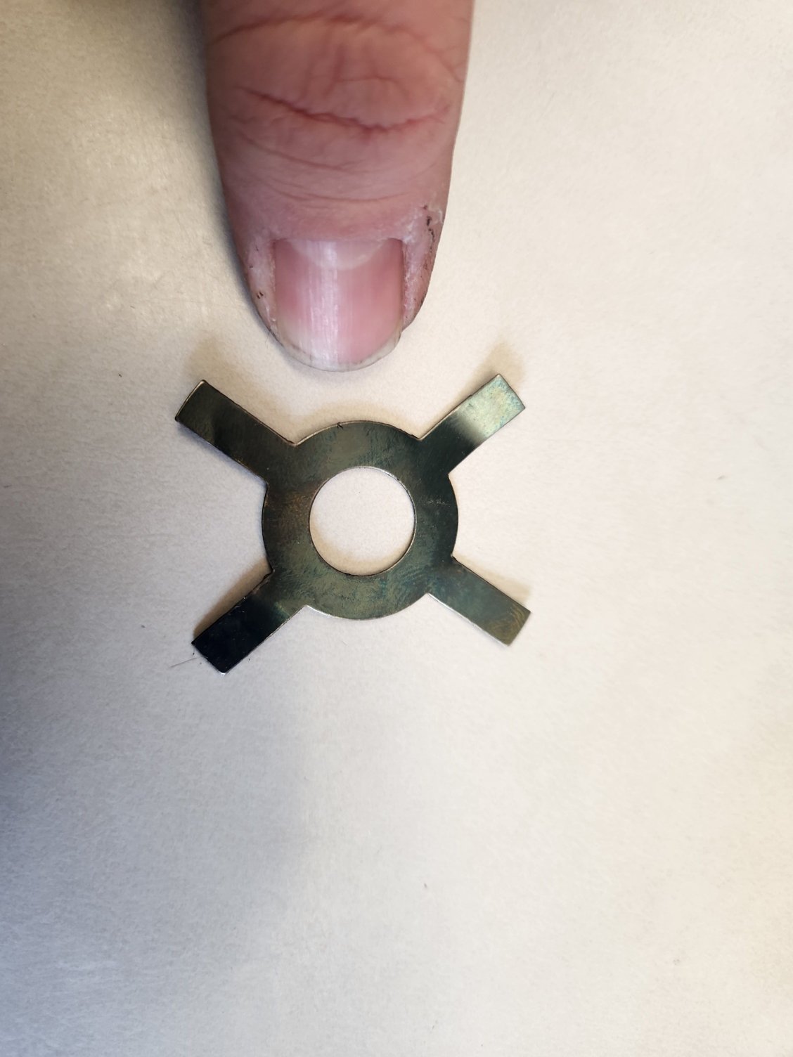

Pics for fun. The old booster was nasty. Wow. Not sure what this metal star thing is for. It was in the box with the booster. No instructions with it. The MC had nice bleeding instructions.
