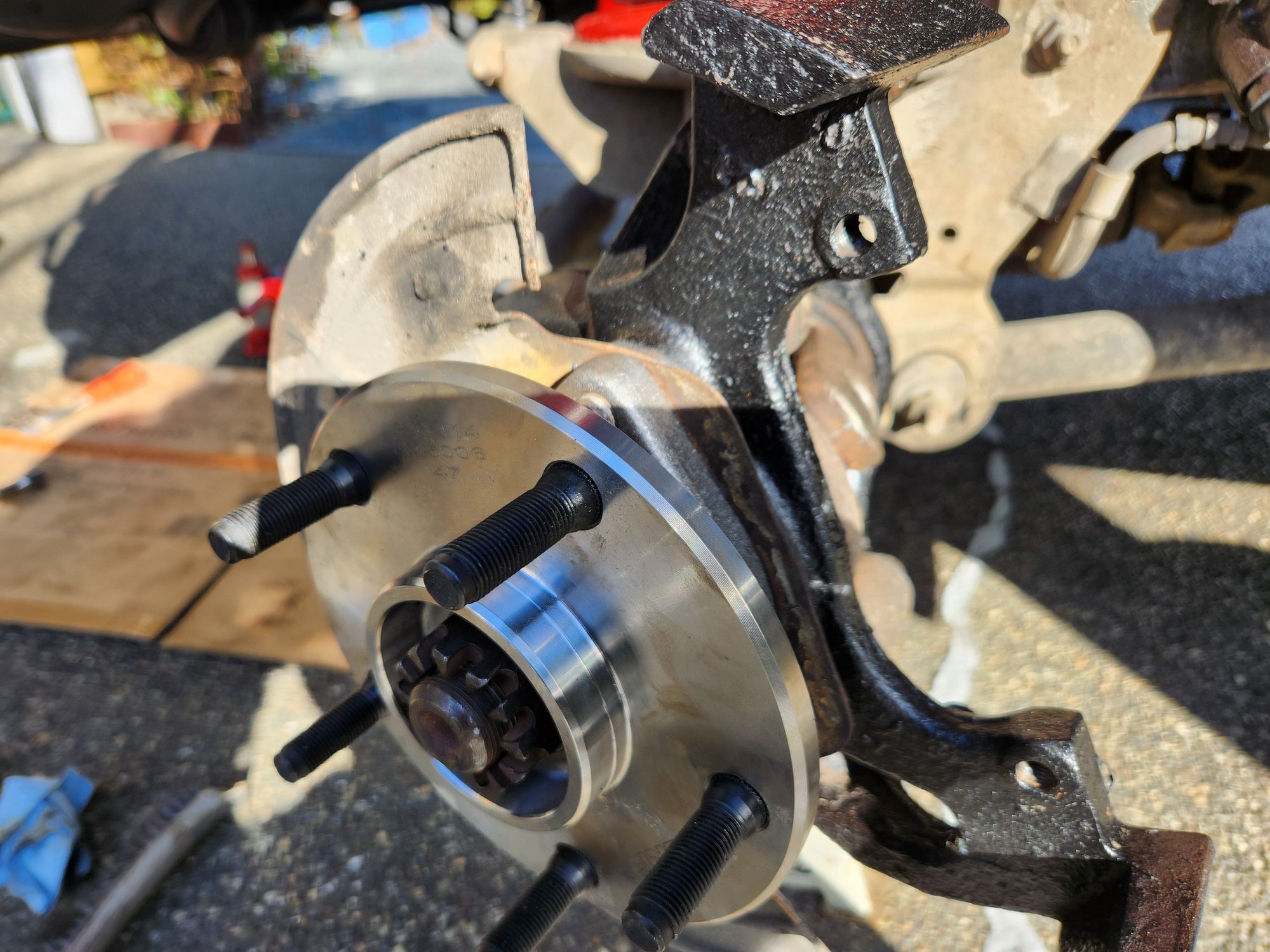

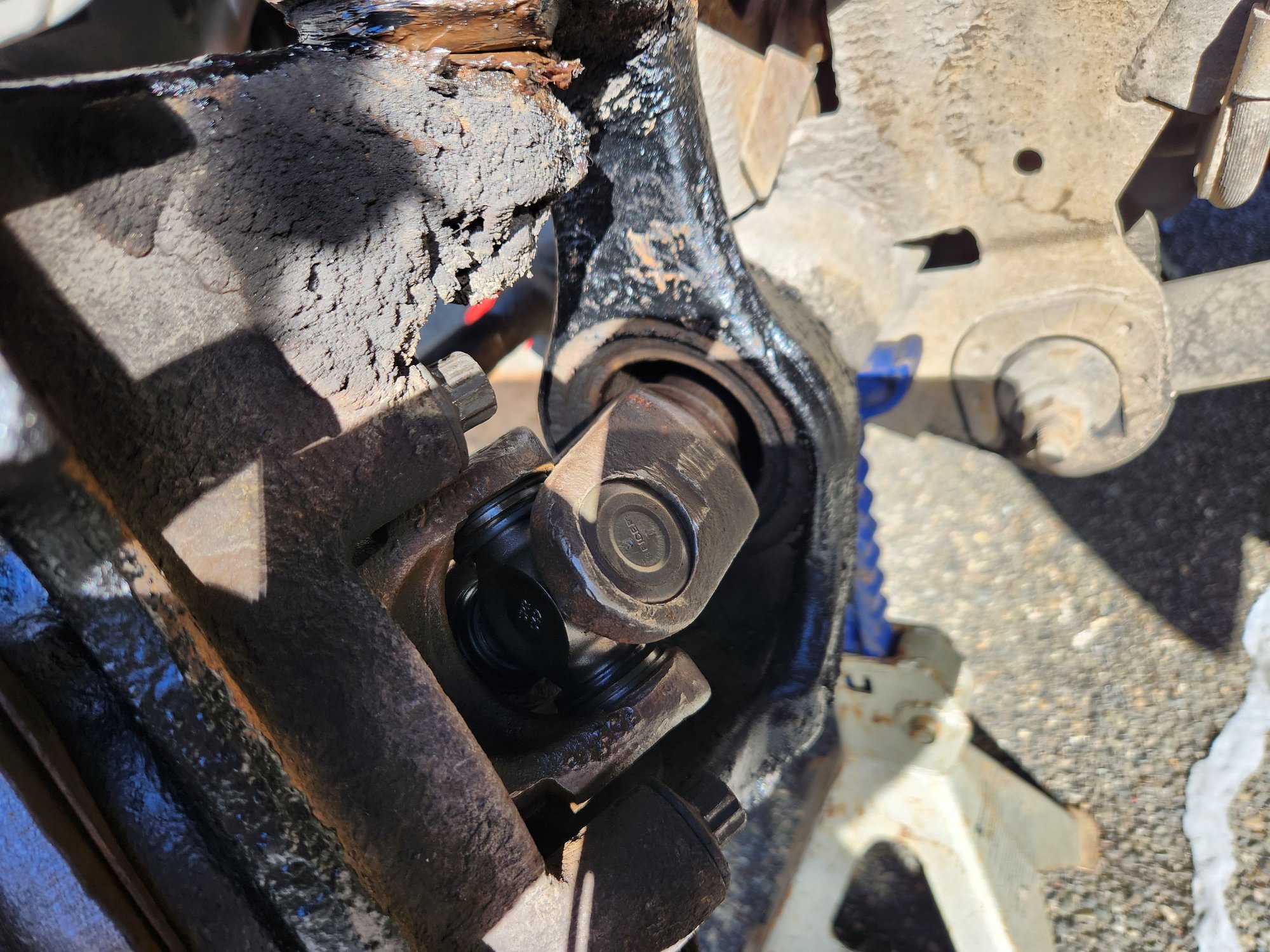

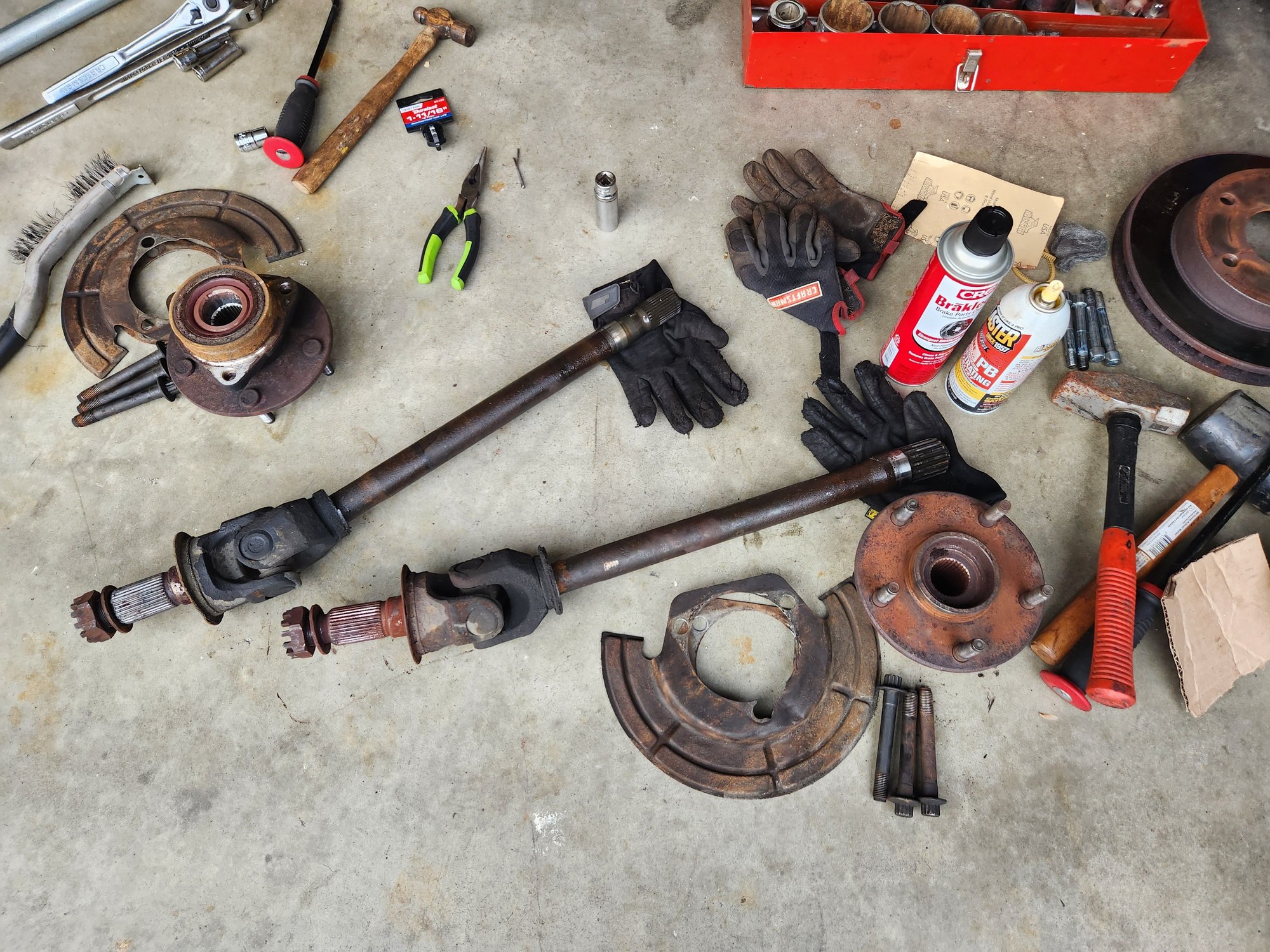

Here are some pics of the work. I know it helps keep y'all interested.
Everything apart. Used the power steering method on the hubs.
Threw some paint on.
SKF hubs. Hope they last as long as Timken.
Spicer 5-760x ujoints.
