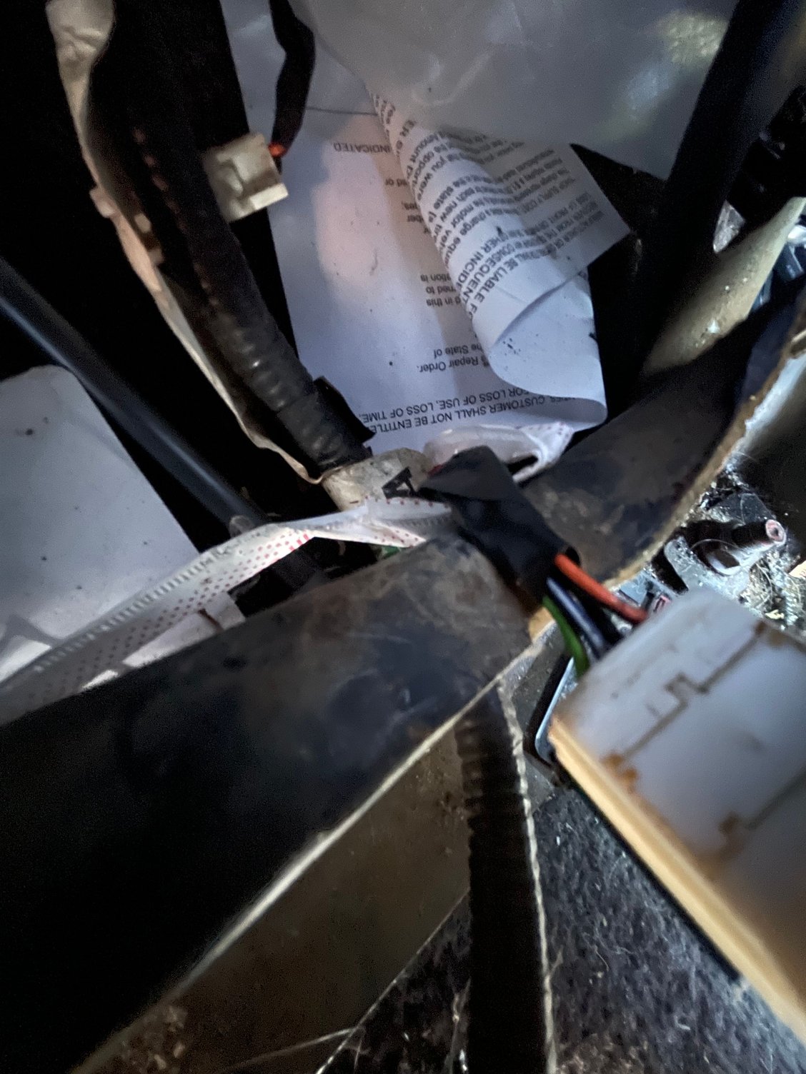

this is the only plug I could find that is attached to the truck wiring harness. It has 4 pins
edit: I found the plug, I was looking at the pictures I sent in the thread and saw a little wire and a plug. Not sure what this 4 pin plug does but that little one is definitely the plug I was looking for, thanks HeyYou
