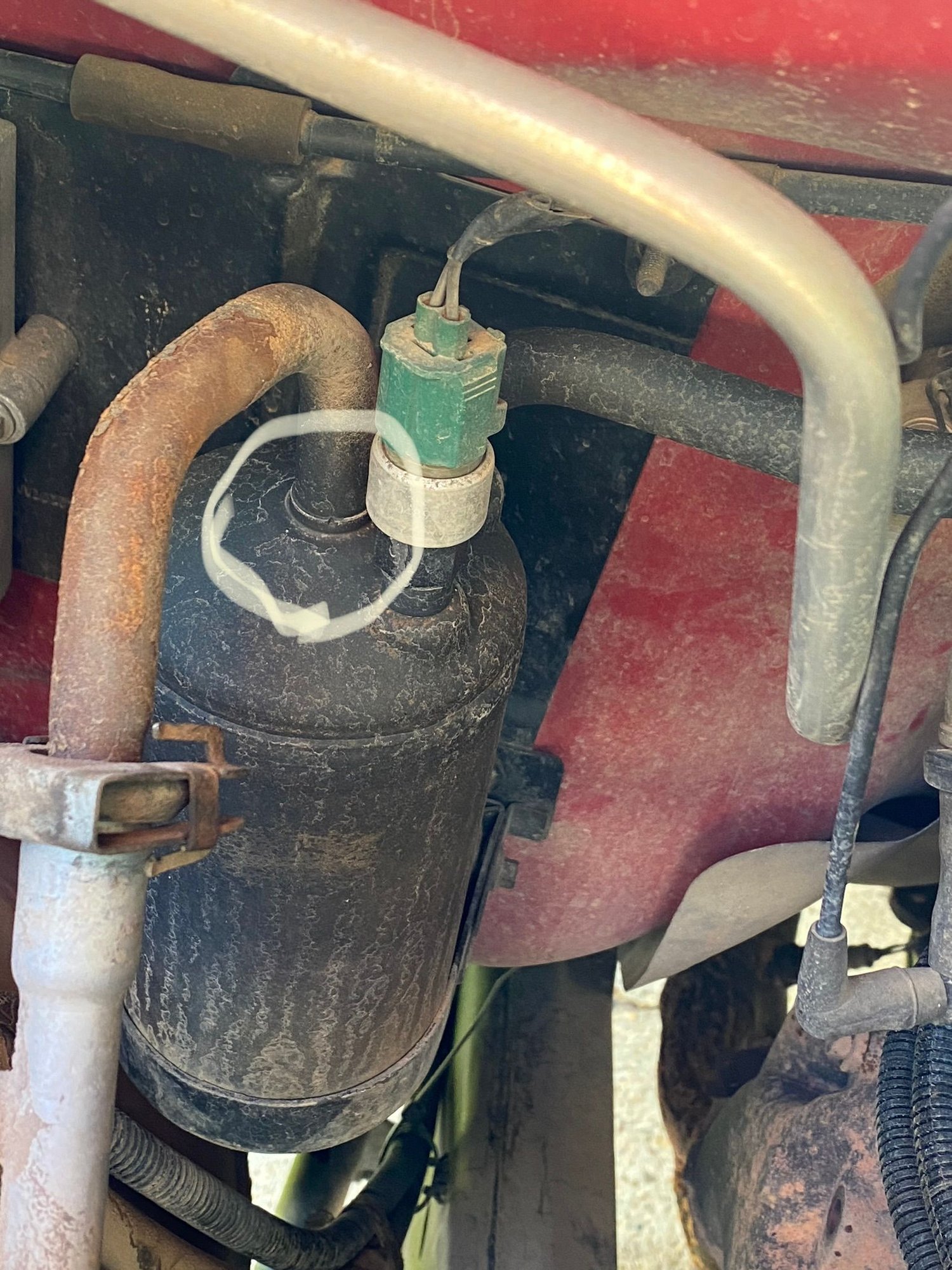

Needing some help/advice. Today when I got home from work I noticed a a decent amount of water behind my left front tire I popped the hood and noticed it was coming from the top of the accumulator where the hose connects in, could this be from humidity? I live in the south. Or do I need to replace the accumulator. Picture for reference

I expect to see some condensation there, if you are running the a/c. (keeping in mind, that it also runs any any setting involve 'defog') If it's fairly humid out, then what you are seeing is probably water from the condensate drain for the evaporator core. That's normal. Verify though that it IS just water.
