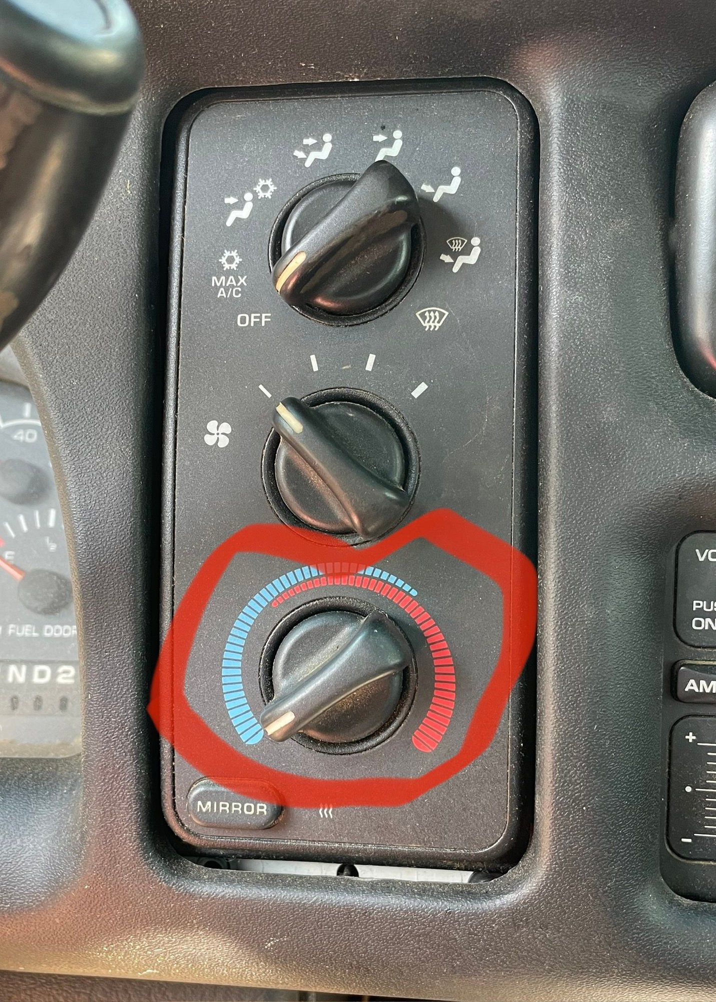

Ok, my a/c would only work on one setting. It only came out of defrost. I found a brittle and broken vacuum line under the hood. I cut and spliced it back together and my a/c, heat, and defrost all work as they are supposed to. NOW when I’m driving and I change speeds, slow down, you hear a thump and hot air comes out a/c vents. I know it's a door under dash, but which? Is it the door operated by switch shown in picture, or another? How to fix?

What are you driving? On the older second gens, the temp door is controlled with a cable, on later trucks, there is an electronic controller, vacuum is not involved. Blend doors like to break though......

OK. You have the electric blend door. There is a coupler between the motor, and the axle for the door, that likes to break..... HeaterTreater.net has the fix. Start there.

if the door you are talking about is the door controlled by the switch I have pictured I’m confused. I can turn the switch to the hot side and it does get hot and if I turn it to cold it does get cold, so the actuator does work. But I can’t pot it in middle to turn heat down, it either goes all the way to hot or to cold depending on which way I’ve got it turned.it’s like the motor keeps turning. Actuator faulty?
Also, it doesn’t act up unless I remove foot from accelerator and slow down. That’s what gave me idea of vacuum issue. Lol, this has this old brain all confused.

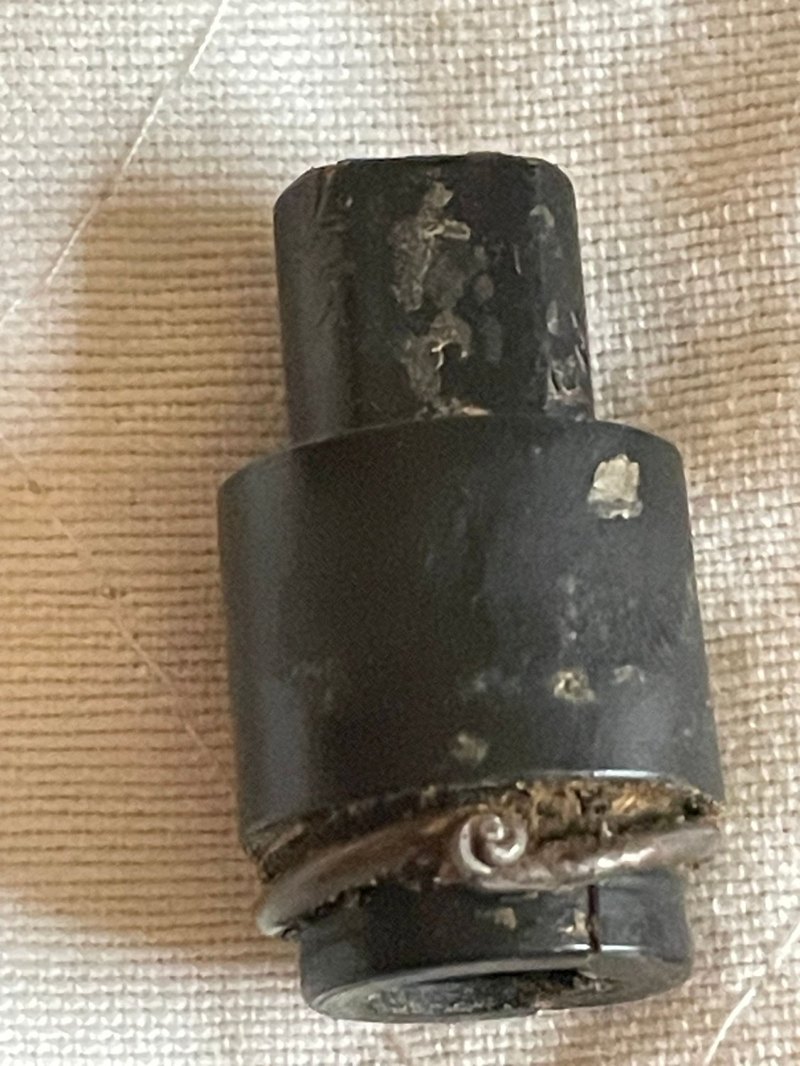

I FOUND THE PROBLEM,thanks to you! I’llt looks as if the previous owner tried to fix this by trying to clamp it. I have the part ordered from Heater Treater.

Yep yep. Standard problem there. Creative attempt at a fix though.
