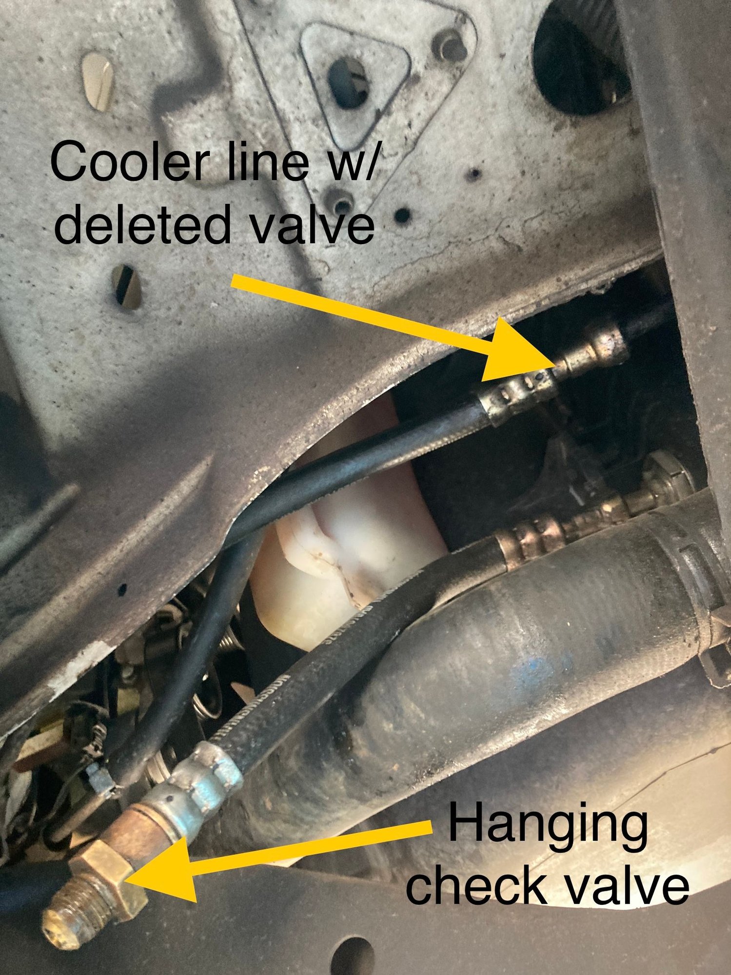

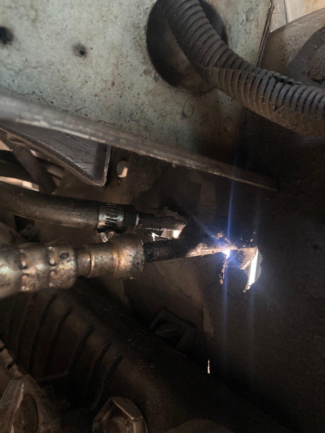

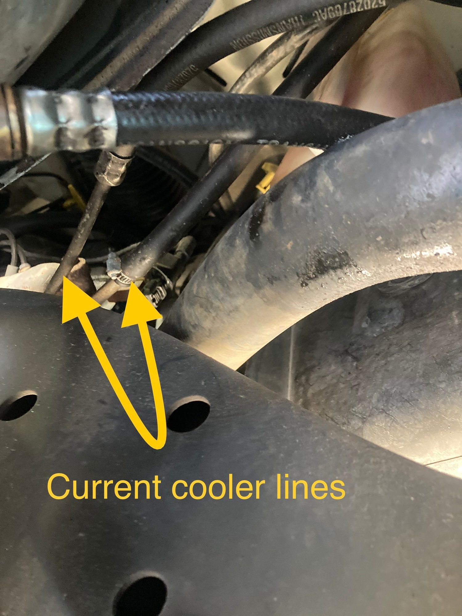

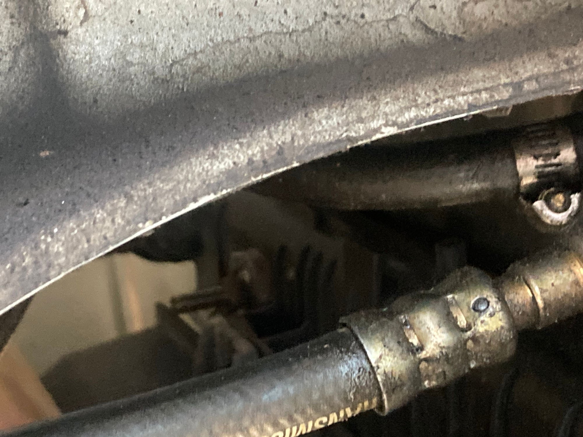

well here’s a wild card, I just got underneath and inspected the lines to confirm size of hose I need when I delete etc and the check valve looks like it’s been deleted already..it’s just hanging there not connected to anything…I’m gonna send photos and update in a minute

Default Reply
How long from startup, to the light coming on? Do you know if any trans work has been done on the truck in recent memory??
here are photos
