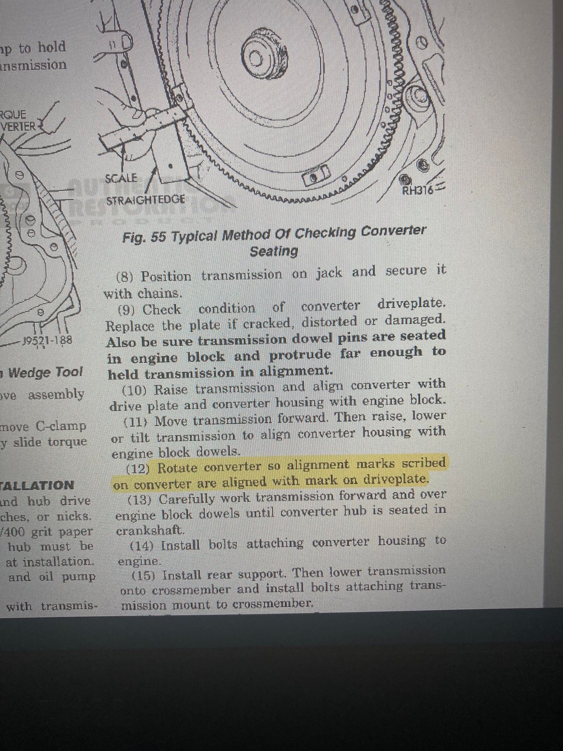

So I think I have a pretty good understanding. And I’m sure I will have more questions.
here is the first one any help on this highlighted portion not quite sure what I will be looking for.

Usually, the flexplate and the torque converter only bolt together one way. Typically, before removing the flexplate from the torque converter, I pick a spot where a bolt goes through the flexplate into the torque converter and paint a spot on the flexplate and torque converter in that location. This allows for the flexplate and torque converter to be easily bolted back up when re-installing the transmission. Keep in mind that if using a new torque converter as part of the transmission rebuild, you will need to match up the new torque converter with the flexplate so that all of the bolt holes on the torque converter line up with the flexplate, then re-mark the new torque converter to match the spot already on the flexplate. This helps reduce frustration when bolting up the flexplate and torque converter while on your back during the transmission re-install process. Hope this helps..

That helped a ton. So new TC no specific line to match up. I thought it was something that can on TC that I had to match up

Correct. No mark should be on the new torque converter, so you will need to line up the flexplate to ensure alignment of the bolt holes with the torque converter and create your own marks before re-installing the transmission.
