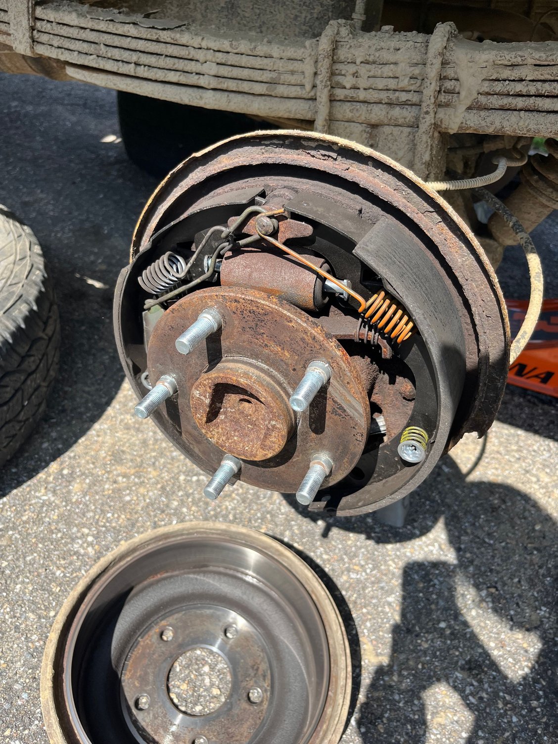

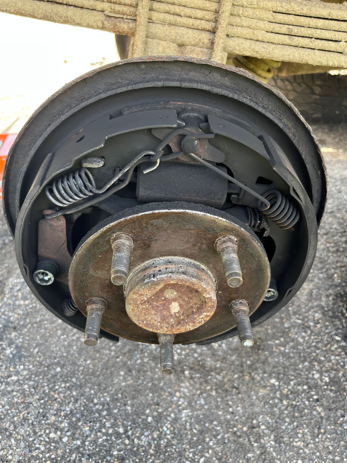

This ended up being the source of the loud noise in the front. The pads still had a bunch of life left and the indicator was bent back on the passenger but not the driver, so i fixed that.
I did check the rears also and the passenger rear had much more brake dust and was very dirty compared to the driver side. It was done before the driver side, though. Would it mean i need to rebuild the assembly?
(First is pass., second is driver)

is the short shoe on the passenger side mounted in the back? If so, that would explain the excessive dust.... The short one goes in front, because it is 'self-energizing'.... I.E. when you step on the brakes, the rotation of the drum tends to pull the shoe into it..... with the long shoe in front, your passenger side brake is going to be MUCH more effective (and touchy) than the drivers side.
Actually, the rear shoe does most of the work on stopping on self energizing and self adjusting brakes. Your brakes are a descendant of the Lockheed system. That's why primary and secondary shoes are either the same or the rear shoe (secondary) is longer. If one shoe is dirty and the other isn't, itusually means a sticky or frozen wheel cylinder. The dirty one is doing all the work. These also have a unique feel to the pedal. I'm not able to describe it but it's sort of you press really hard but don't get proper results. After 50+ years of all sorts of brake work, I can often tell by feel what's wrong.
If it was my vehicle, I'd check the wheel cylinders. They are fairly cheap to replace. A few specialty tools and it's a simple job to replace them.
The shoes inside the drum look good, to a point. The bevel on the shoe means there's plenty of meat on it. When the bevel is gone, the shoes need replacing.
