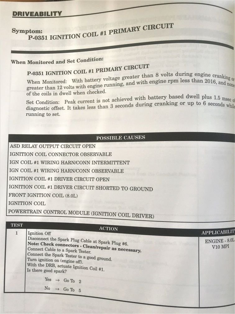

Fair enough. "The power to the coil should be always hot..." While running. His engine runs, therefore..... Back to wiring.
The function of the cam sensor is to tell the PCM where the crank is in it's 720deg of rotation, and provide evidence of life. No cam sensor, no life, no ASD power. Replacing the crank sensor on an engine that runs sounds like forum parrots talking.
This is my OBDII bible. Have one for '95 as well. Try to get away from the idea that you need the DRB scanner. Voltmeter, continuity light, jumper wire and a wiring diagram will let you do much of what is in here following the logical steps. Forum parrots tells you to throw unnecessary parts at a truck without figuring out what is wrong.
Looks like Hey You is right to me.

69_XS29L's Avatar
69_XS29L
Joined: Mar 2013
Posts: 277
Likes: 37
From: Sunny ****ing Nevada, Rockies to B.C.
Here is one way to think about the problem.

Thats some good things to check. I do get a code for the secondary coil. I'm assuming it's the same test procedures as the primary coil that you posted those pictures of? With the exception that it's a 4 coil pack not a 6 on the secondary.

What codes are you getting? I can screenshot the diagnostic tree for that code if you like.
You also need a service manual/wiring diagram to track stuff like this down. Hey You can provide a link for downloadable manual, pretty sure.
