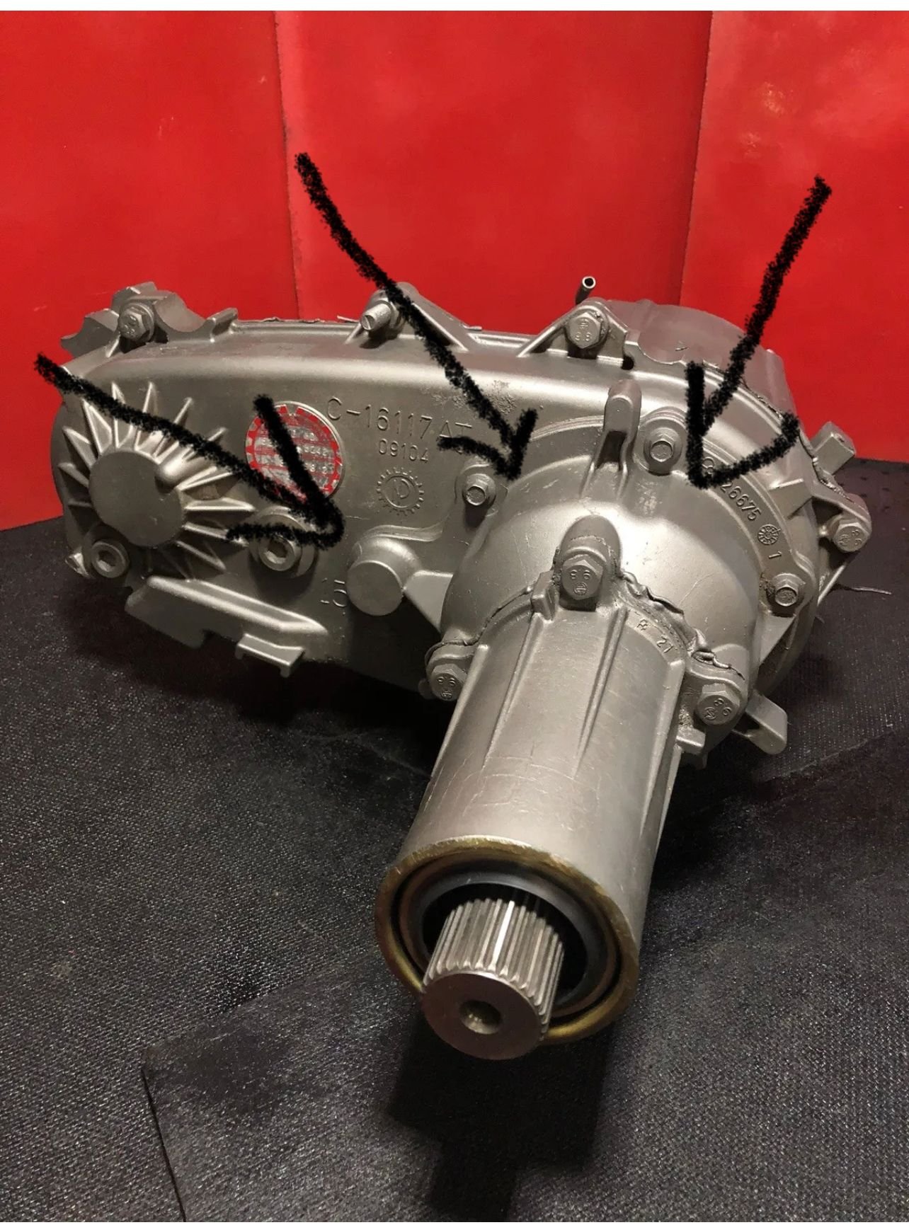

That goes between the main shaft rear bearing retainer and the rear case, so it would shim something. However, there is no tapered bearings, so I don't know what difference it would make. Can't find any seal/gasket kit that would have that. And looking at the picture of my t-case in pieces on the floor, all I see is RTV on the rear bearing retainer. Can't recall there being any kind of shim.

the gasket goes here. I’m not sure what if any difference it makes, but I don’t want that little bit of space to cause a complete failure of the transfer case.
